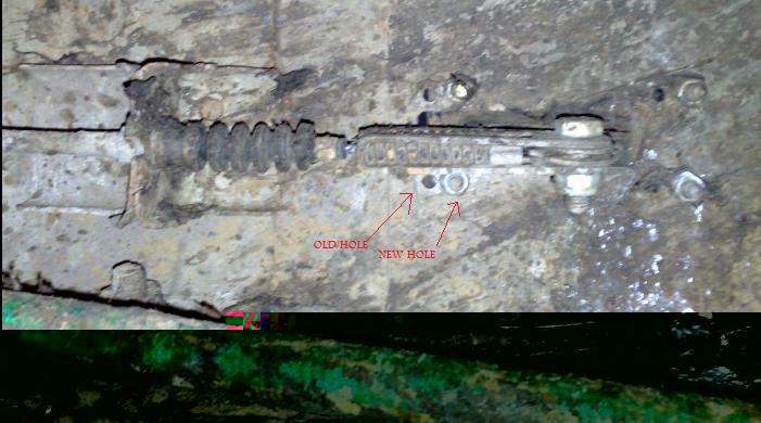

when I modified th sj into the blitz i ha dto change the fixing of the cable too. and i have a tb from a 410 as well.
so above the transfer box there is a cross member. if you put your brakecable along it starting at the hand brake the nuts are going to be near that cross member. you just have to get a L shaped plate, bolt it on the cross member and attach the cable to it.
I get some pics for you in the mean time i made a wee drawing if it canhelp :roll: :roll: :roll:

here are the pics of the bracket. you will see on the 2nd pic where the old hand brake cable mounting was. hopeit helpsImage

that is a great help 8-) as i is to doing this i have looked at it and tryed to find away with out doing a bracket but its no good
going to have to make a bracket like that
