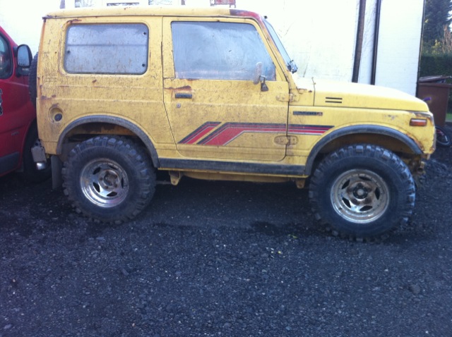

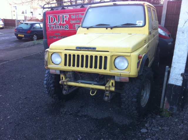

Sorted. I've made a set of body lift blocks with special studs that thread on the existing ones to save all the hassle. Spacers are on wheels are on and no rubbing at all. One drawback with fitting the big tyres tho is it sacrifices the low gearing and i now find I have to keep on the clutch when in deep mud or water to keep the revs up.

Post by felstmiester » Sun Mar 20, 2011 12:55 pm
Ha wheels are worth more than the the zuke its self :lol:
