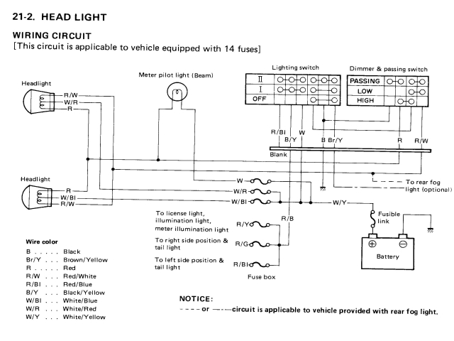

Does the rest of your wiring work : horn/wipers/dash fan
If not then maybe your fusible link has blown.
The headlights are on a different circuit to the tail lights so I would not expect both to fail.
Having said that it wouldn't run either though if that link in blown. :er:
Headlamp Circuit.jpg (120.99 KiB) Viewed 6635 times

Got power coming to the stalk on the dash from the white lead. Is there anyway i can bridge it to see if its the switch that is at fault? Ill pick through that wiring diagram and see

if you link the white to the black/yellow wire the side and tail lights should come on.
These lights are switched positive. The headlights are switched negative.

Ok, now i have side lights and rear lights when bridged.
Best clean the stalk up!

If you connect the red wire to earth high-beam should come on. (this will spark a little if just poking a bit of wire in)
