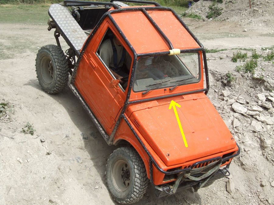

Where does all the crap come from that ends up in the blowing unit thing? Where's the pick up?
Re: Quick question
Post by ROBBIE » Sun Oct 16, 2011 10:30 am
the vent in front of the windscreen i tape mine up when off road to stop the crap getting in
Re: Quick question
Post by Darrell » Sun Oct 16, 2011 10:34 am
Christoff wrote:Where does all the crap come from that ends up in the blowing unit thing? Where's the pick up?
Goes in here

Post by ROBBIE » Sun Oct 16, 2011 12:13 pm

Post by Christoff » Sun Oct 16, 2011 1:23 pm
Gaffa tapes as good as anything for me I think. Im not a serious off roader just yet ;)
