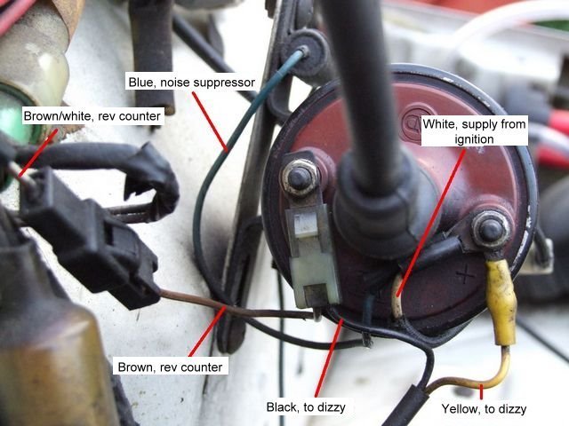

Post by Darrell » Sun Apr 01, 2012 5:56 pm
Normally goes to the coil negative terminal. I would give that a try.
413 Coil Wiring.jpg (60.64 KiB) Viewed 7683 times
Re: rev counter is not working
Post by turbo-tom » Sun Apr 01, 2012 6:42 pm
cheers mate for that , just tried it and no luck :roll: , just going to by a universal one i think now
thanks anyway :thumbup:

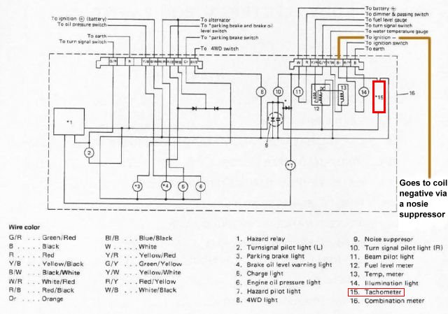

Post by Darrell » Sat Apr 07, 2012 9:27 am
More info.............

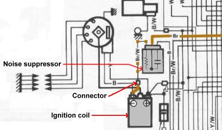

Re: rev counter is not working now its gone up the swaney!!!
Post by turbo-tom » Sat Apr 07, 2012 2:26 pm
im not that good at diagrams pal!
ive got the brown and white wire comming out of the original loom and thats it and its been cut off ? tried putting into the coil were suggest and got nothing...
does it have to go through a noise supressor or something ?
Post by Edweird » Sat Apr 07, 2012 2:42 pm
That would probably depend on the one you've bought as to whether it need to go through the suppressor. Given your old one stopped working the suppressor is one of the things that could have broken though.
