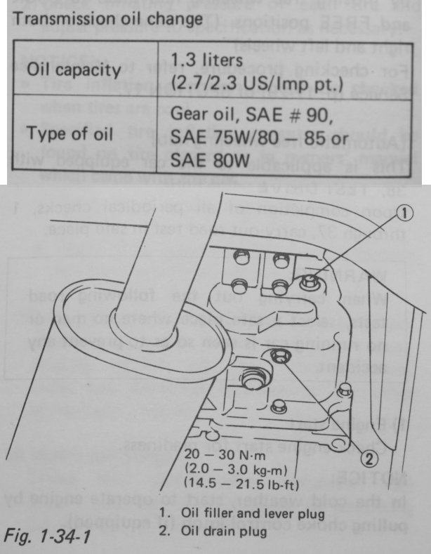

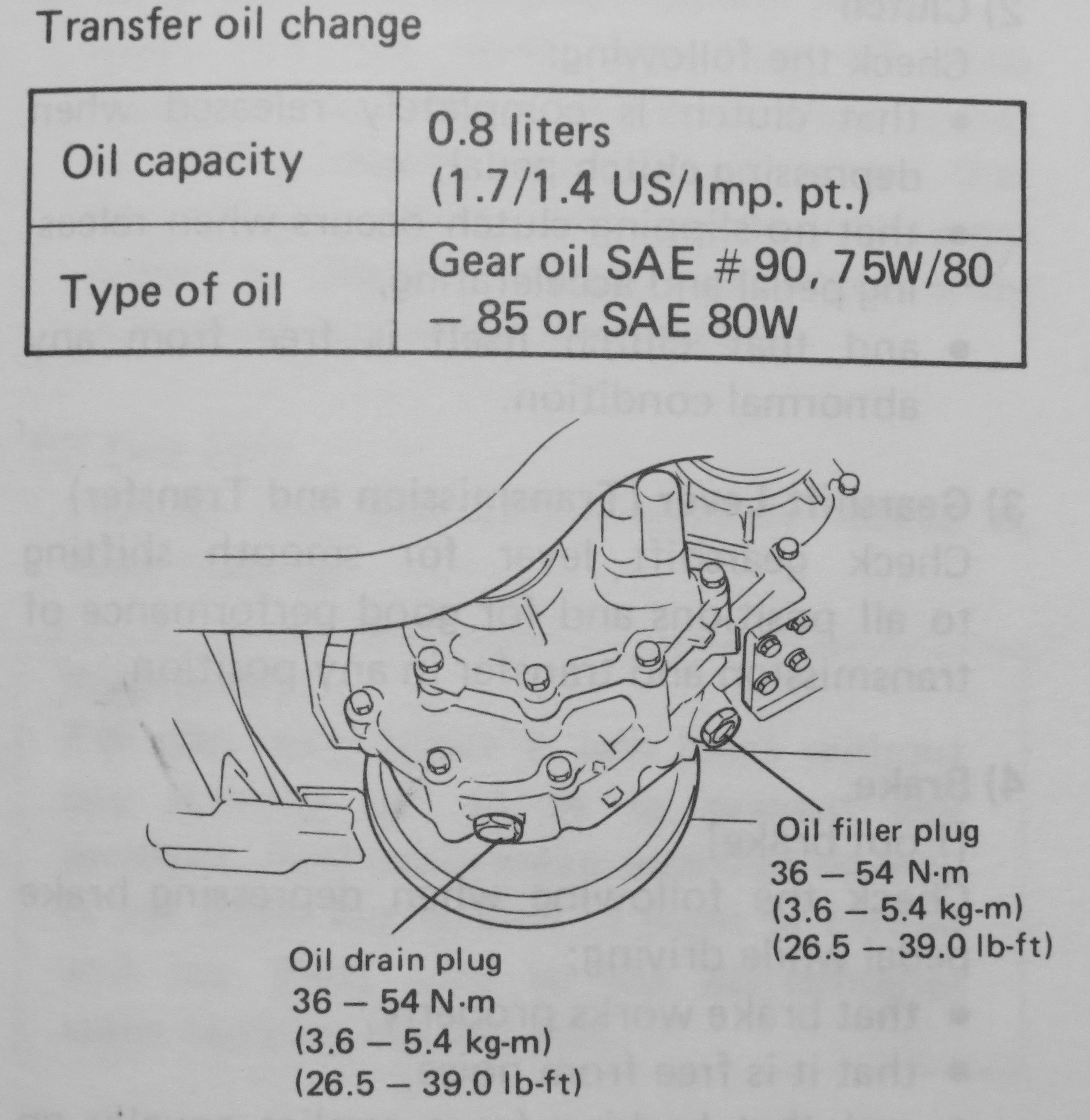

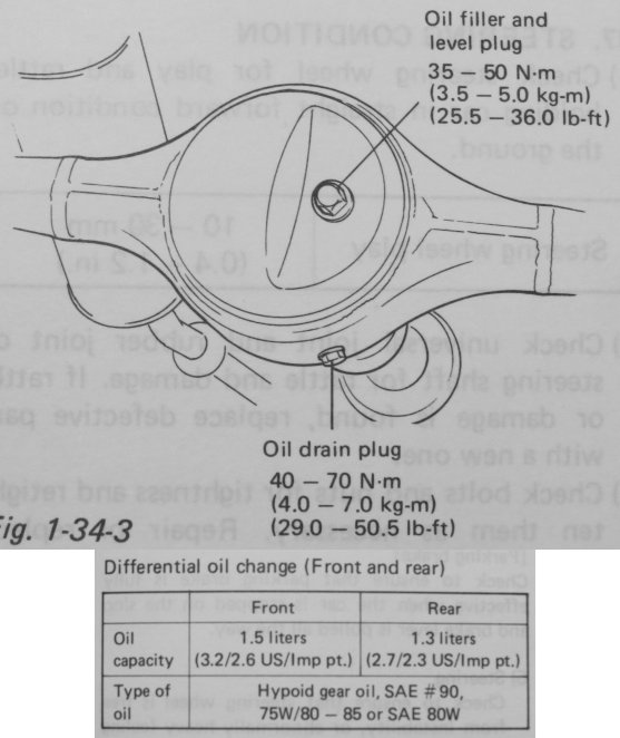

i seem to have a nasty whine coming from the gearbox on my samurai.
its the first sammy ive owned and only driven it a handfull of miles so im a bit in the dark. is this a common problem? seems to be worse the faster i go. it also hasnt been on the road for 3 years :S
Posts: 11718
Re: whine from the gearbox??
Post by ScottieJ » Tue Sep 11, 2012 10:00 pm
First things first have you checked the oil to see that its not contaminated and that it actually has enough oil in it?
Personally changing all the oils is the first thing I do when I buy a vehicle.

i havnt a clue about the vehicle yet, where are all the transmition oil level check places?
Post by Darrell » Wed Sep 12, 2012 12:20 am
:salute:
Diff oil level.jpg (53 KiB) Viewed 11673 times
Transfer oil level.jpg (841.94 KiB) Viewed 11673 times
Gearbox oil level.jpg (65.14 KiB) Viewed 11673 times

Post by james thomas » Wed Sep 12, 2012 9:23 pm
thanks darrell, thats just the info i needed, im a picture man, not a reading man
