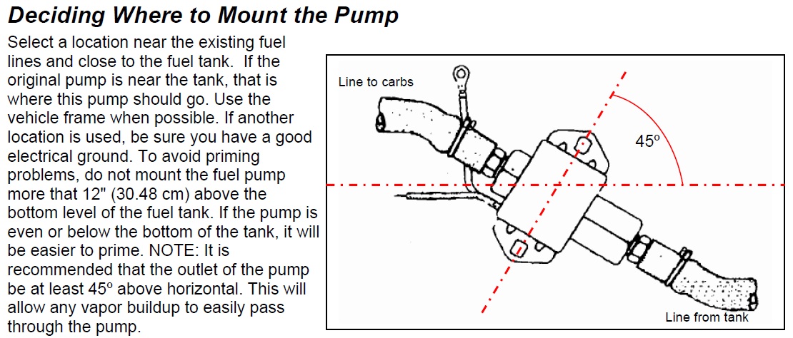

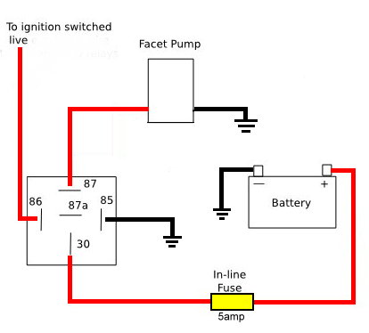

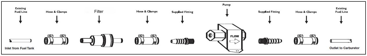

I though we could do with a bit more info on here about facet pumps so have found/done these.

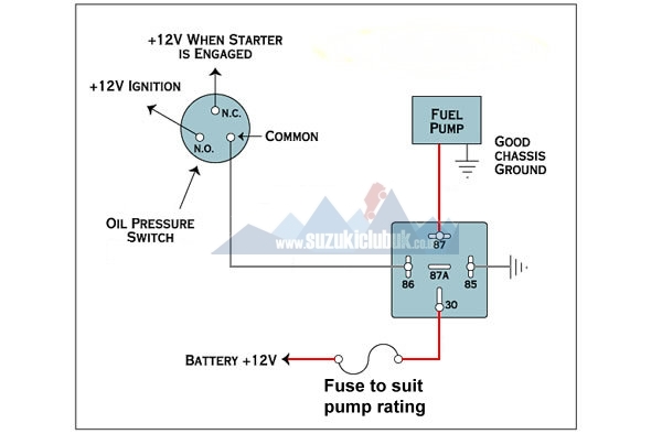

Ideally an oil pressure switch should be used with the fuel pump for safety but it seems most people don't bother. Using a relay is recommended too.
pump 1.jpg (193.27 KiB) Viewed 5982 times
pump 2.jpg (32.88 KiB) Viewed 5982 times
Pump 3.jpg (18.86 KiB) Viewed 5982 times
Diagram for anybody wishing to use a safety switch.
Fuel pump safety switch wiring.jpg (43.41 KiB) Viewed 5982 times

Facet don't do oil pressure switchs. They recomend wiring it into to the ignition with a relay on their website.
