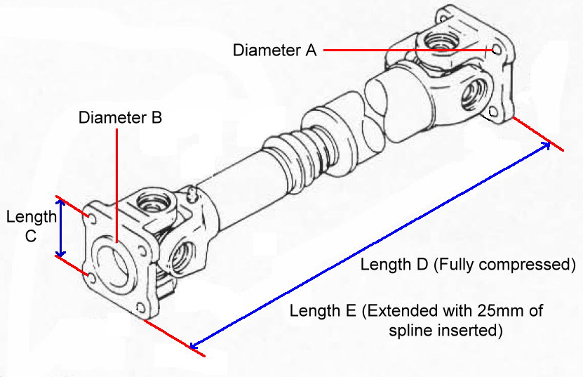

Questions have popped up quite a few times regarding propshafts and I don't know of a useful list of measurements. So I've done a diagram (there's a surprise) and hopefully you guys with spares can get a few measurements for future reference.
prop diagram.jpg (69.23 KiB) Viewed 10972 times
The pcd can be worked out as length C divided by 0.707
My D reg SJ413 ,The only info I have is
A= 8mm
C= 56mm
PCD= 79.2mm
Universal joint size =
Well it's a start :oops:

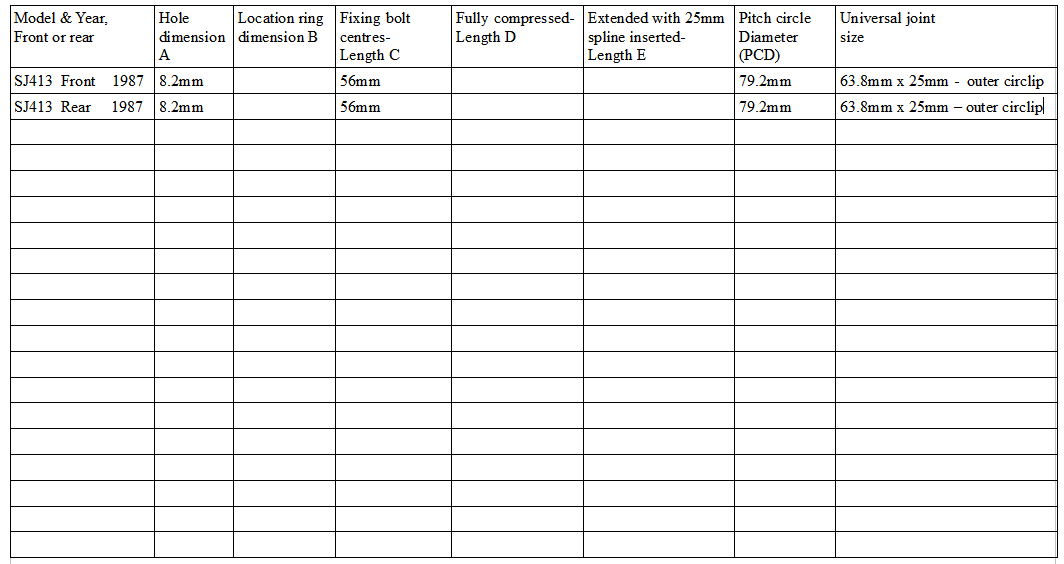

Post by Darrell » Sun Nov 04, 2012 8:44 pm
Well I've been searching the tinternet and found absolutely sod all info :thumbdown:
We can add to it in time I guess :popcorn:
prop info.png (30.24 KiB) Viewed 10924 times
