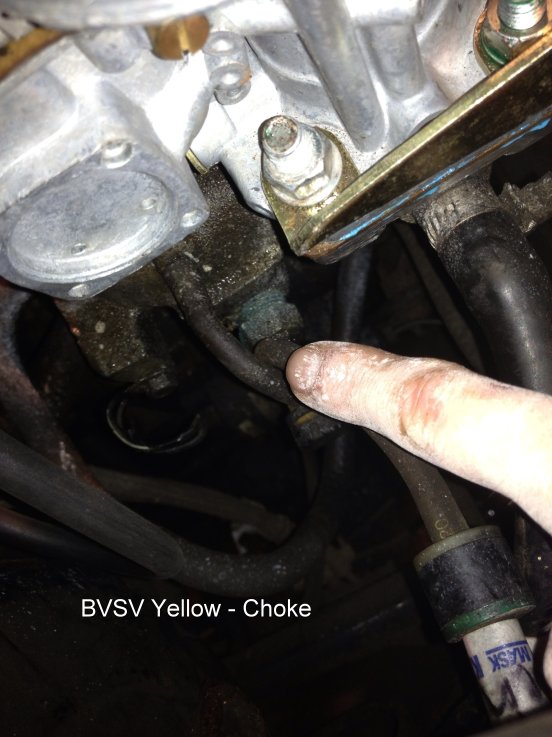

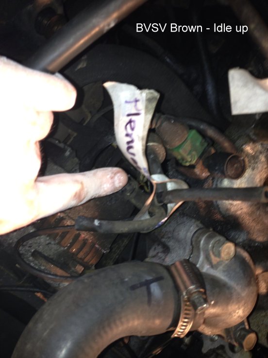

Also anyone know what these are and if I need them with the webber carb?
Or can anyone see anything I've done wrong as hopefully tomorrow she will be finished off and hopefully started for the first time in over a year!

Hard to tell what that is...might be the oil pressure switch?

Dont know what they are exactly but some kind of vaccum for the old carb.
Anyway I know you need to blank them. Just put the hoses onto each other or put a screw down the hose.
As long as nothing can get in or out it will be fine.

Im an SU convert. I know those pipes are vac advance and mine are just blocked off. I know when i converted my SJ carb to a daishitsu carb it didnt have enough pipes so the SJ vac advnces got blocked off too. That still runs fine.

You don't need either of those valves with a weber. One was part of the auto-choke and the other part of the idle-up system.
