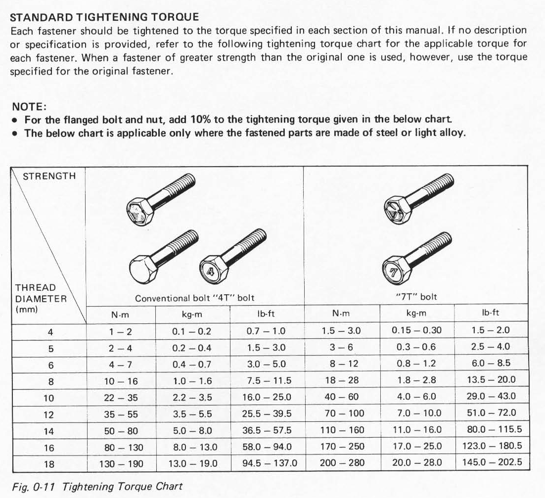

The number 7 denotes it's strength and tightening torque.

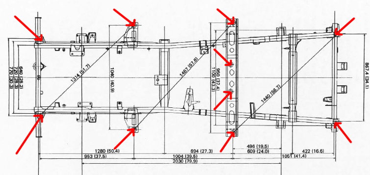

Which bolts are you after, not that I have any :oops:
Chassis mounts.jpg (60.26 KiB) Viewed 6019 times

Hi Darrell, thanks for taking the time to reply. It's the ones that bolt onto the cross member, the ones that fit into the cone shaped body mount ;)

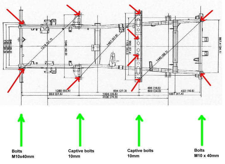

I'll be honest I'm a bit confused. I've never taken the body off but I believe other than the ends they are captive bolts. If this is the case you would not be able to see a bolt head with a number on it??
The others are standard M10 bolts. My searching says they are 40mm long, but I have no idea.
Plenty of the guys have taken the body off so hopefully they can give you better info later :thumbup:
My take of it ??
Untitled - 1.jpg (74.13 KiB) Viewed 6011 times

Robbed this from the manual..
Suzuki bolt ratings.png (747.42 KiB) Viewed 6008 times

Oh and just to confirm. The info Darrell gave regarding which are captive and which pass through the body is correct.
