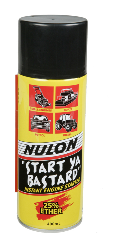

Post by Darrell » Tue Dec 31, 2013 8:20 pm
You need a tin of this..
It's out there and it works.
:D
