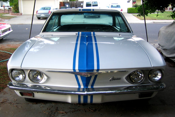

Re: Restoring a SJ van body.
Depends on the finish your after.
Rolling and some elbow grease can get amazing results
http://www.rickwrench.com/index79master ... paint.html
Painted with a roller
- polished4.jpeg (67.08 KiB) Viewed 8015 times

Wow, that finish is amazing! I'd like to point out that I'm not aiming towards that standard. If it looks good from 6ft away, it's good enough for me!
