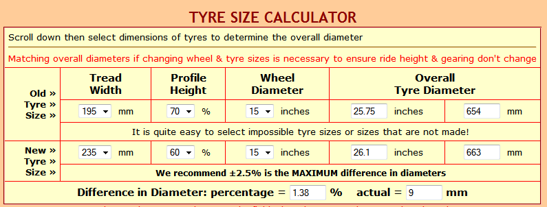

Accord to the calculator 1.38% bigger :thumbup:
