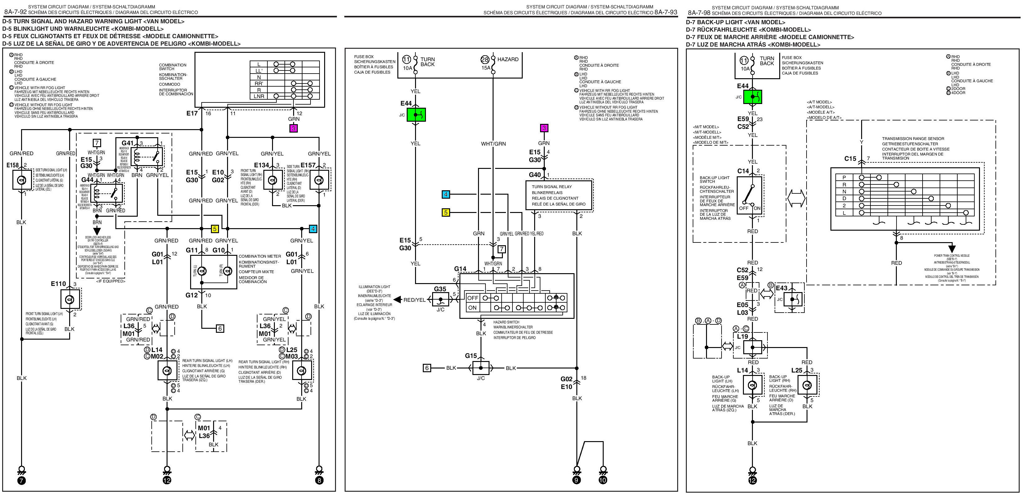

Hi i own 51 plate grand vitra 2.0td which keeps blowing indicator / reverse light fuse checked all bulbs earths even changed indicater relay ok till to start car then blows fuse any suggestions pls help

I have taken the relevant sections from the workshop manual and coloured a few points to clarify connections a little.
There is different 2.0l diesel engines fitted but I hope/assume the indicators/reverse circuits are the same.
Grand Vitara 1999-2003 Fuse 11 Turn-Backup.jpg (714.66 KiB) Viewed 10855 times

Re: i ave electrical problem
Post by Brrok_lands » Tue Feb 10, 2015 11:38 pm
Could be a chaffed wire somewhere that shorts out when it moves with the vibration from the engine. I’m afraid something like that usually takes a lot of chasing down.
Post by Anton » Wed Feb 11, 2015 1:49 pm
A worn wire causing a short would be my guess too.

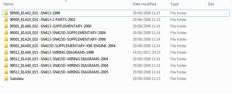

Post by Darrell » Tue Feb 17, 2015 7:58 pm
Loads :thumbup:
I have these manuals in my collection (pdf only)
What you after.
I assume any diagrams would be from the 1998 print (yours being a 2000), unless they did any more workshop manuals before the 2004 print ??
