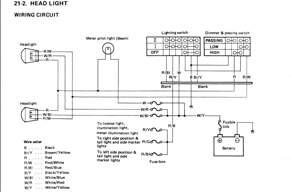

On a 1988 SJ410 is the side lights' wiring split side to side? I've got a funny going on with the side lights/indicators - I've lost power to a front side light and the rear light interacts with the indicator both on the same side..? :S

It's normally bad earths that make the lights play silly wankers :thumbup:

Darrell wrote:It's normally bad earths that make the lights play silly wankers :thumbup:
Yes that's exactly what they're doing! :D
I will look at earths but I'm also mystified as to why there's no volts in one of the connectors on that side, hence wondering if they were separately fused.
Re: SJ410 lighting wiring
Post by Darrell » Sun May 14, 2017 4:30 pm
I believe a 88 410 lights are wired same as a 413. Yes fused either side, like so..

Aha yes I've been looking at a dead green and red wire so that makes sense, thanks for that.
