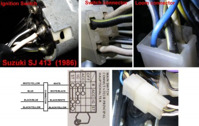

My Ignition barrel colors are W/B, B/W, B/Y, W. Should i be taking these colors from the Ignition Barrel or the Loom?

Does sound like you may have the ignition circuit connected to the ACC position on the switch. This would stop it sparking when cranking but would resume after cranking which may be why it fires a little after trying. Don't know if this will help ..
