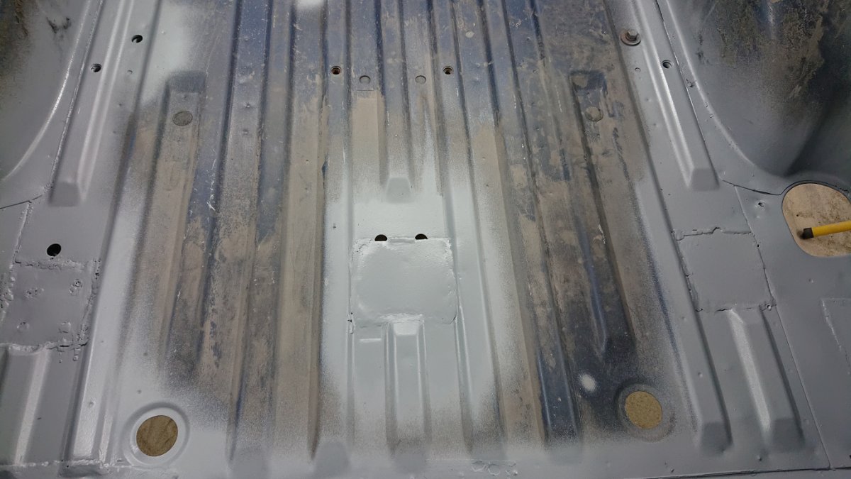

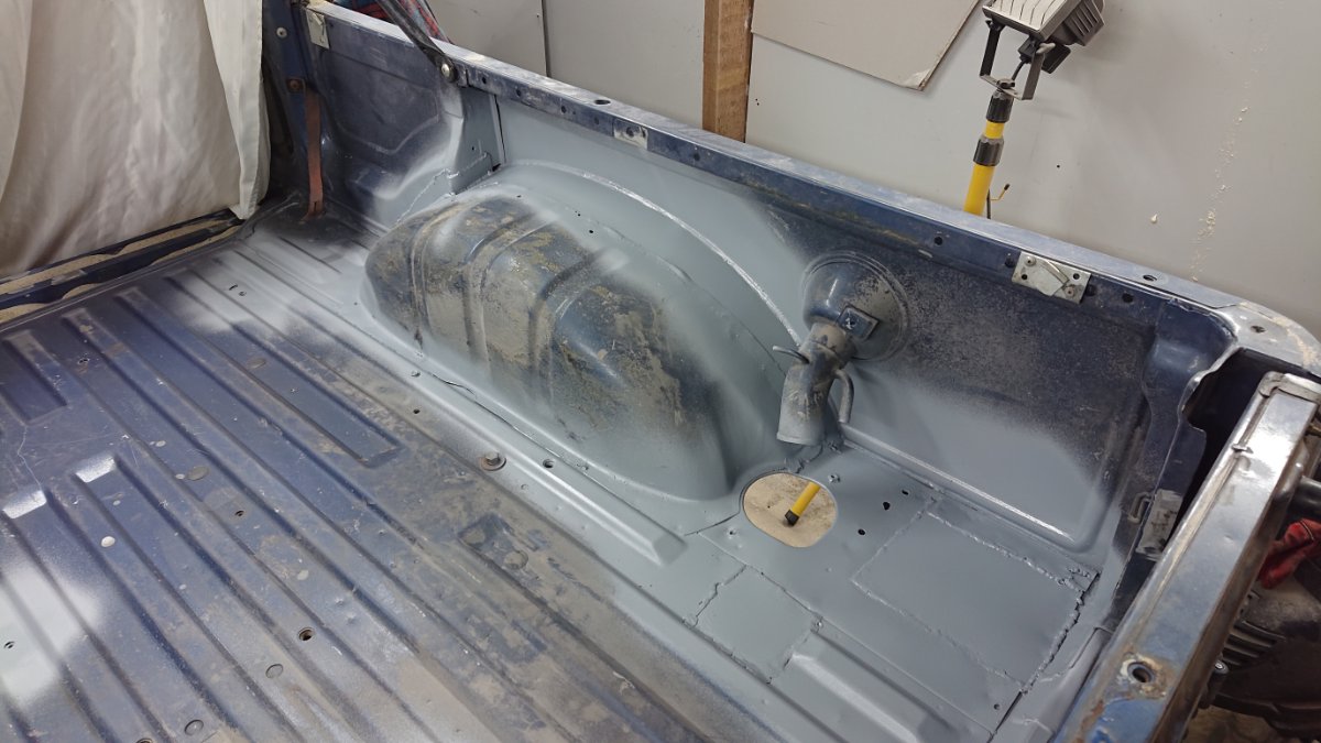

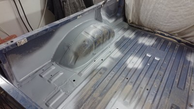

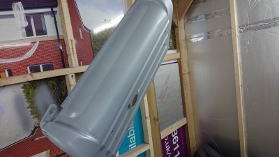

Removing all the sealer the welder fitted has not been fun as the blaster can't get into it without wasting media.
But its all off now and i have blasted the floorpan and epoxy primered it up. Onwards and upwards
On a bad note my friend who was a professional resto guy came to see the sj. He totally tore the welders work appart, pointed out lots of warping i had missed and gave me a reality check. Rear quarters and one sill area are warped to hell so more work to prep for paint now
Anyway heres a few pics as to where im at. The sides and underside are next to blast before i get it running again and epoxy the new front wings.
Its a little behind but march is still doable
