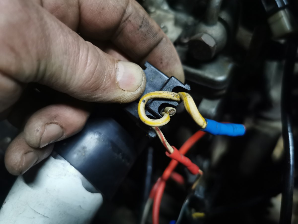

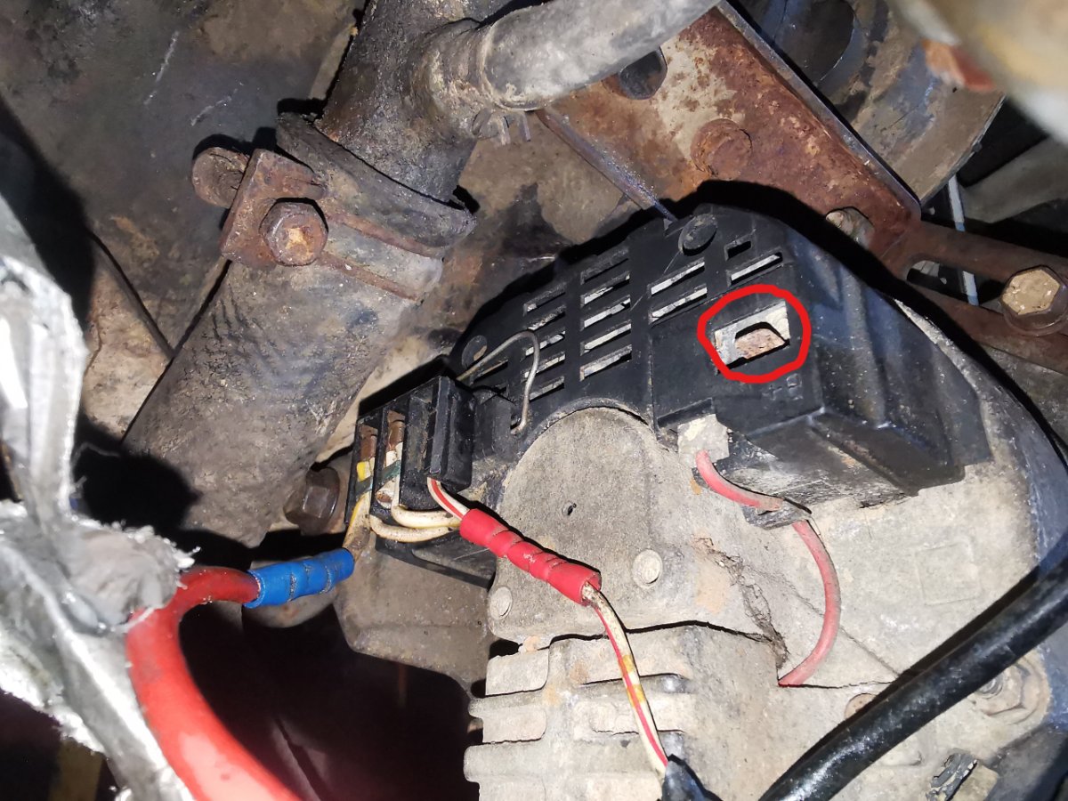

This is my SJ 410 Alternator wiring , bit confused as in first pic in the plug there is 3 spade connections, but the Yellow/ white is spliced in to 2 of them and the White /Red to the other. , I have another wire coming from loom with those 2 but it is not connected to anything, it is Black / White.
Should it go to that spade circled on Alt in second pic , or to one of the spades in Plug ??
