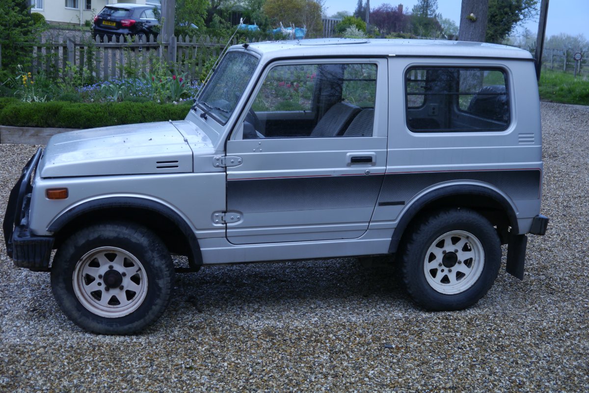

I have to do some bodywork on my 1983 SJ410 (see pic), and that includes replacing some original halftone decals. Is there a good way to do this?
Any hints gratefully received!

The decals are a nightmare to get off.
Hair dryer / heat gun, try and warm the glue up and peel off with a sharp scraper.

What Jordi says. But use a plastic scraper or you'll ruin the paint.

Agree with Jodi, but also recommend sticky stuff remover, great stuff for getting sticky residue off

I'm thinking I might be better off trying to match the missing two. They are a bit tricky as they are part transparent. Don't imagine originals are still available. Anyone with any experience of this?

I would think any of the many vinyl sticker/ car wrapping places could match the originals for you.
