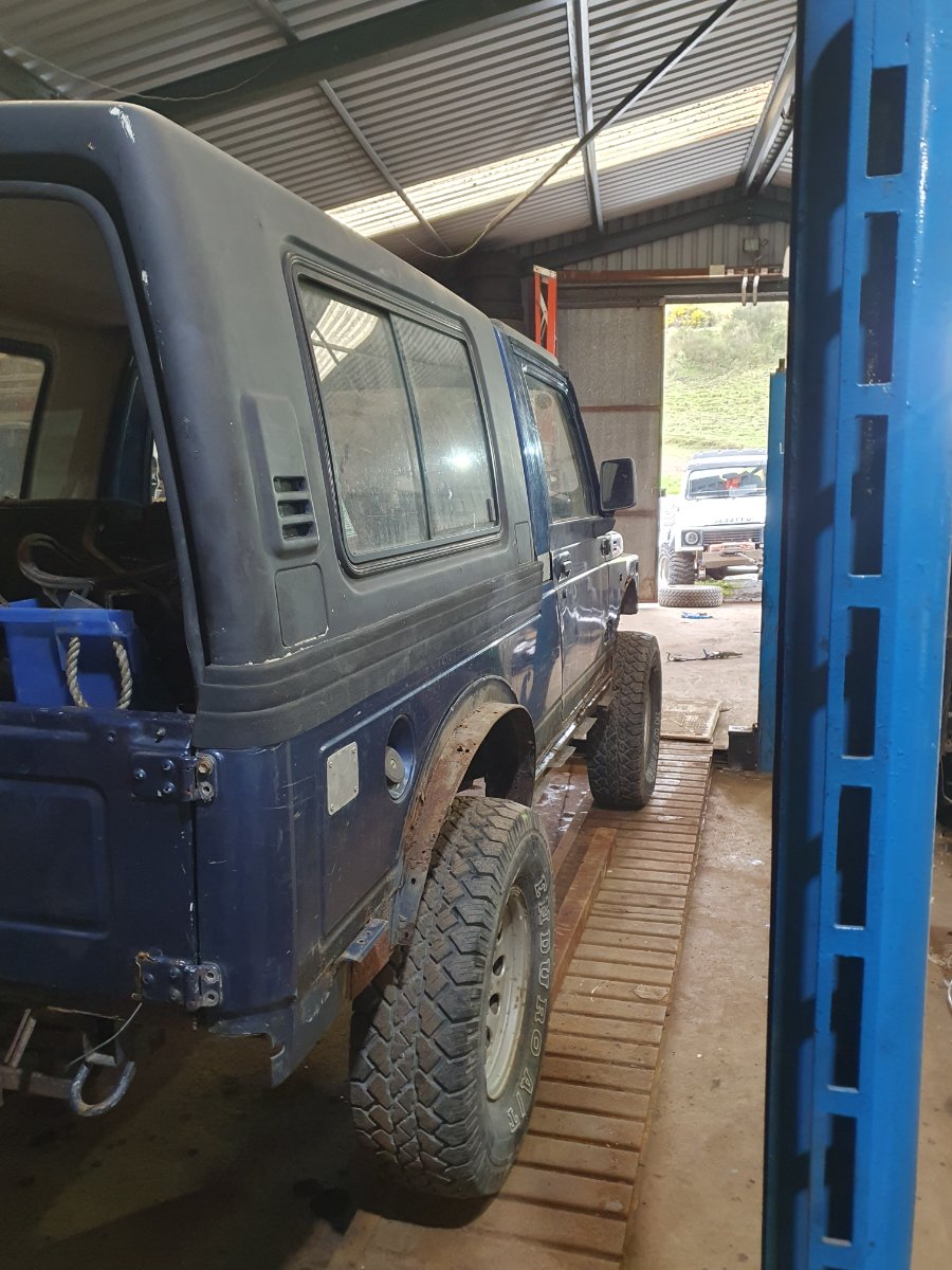

Good morning everyone, I've been after a long wheelbase for a while now and luckily Mike managed to sort me out with one.
It arrives Thursday and the wife's been away since Saturday morning so I've had a good stint on it already. Sadly the welder packed in last night when I got to the rear arch.
Managed to get the new 50x100 sill on and the front arch tubbed before hand tho.
