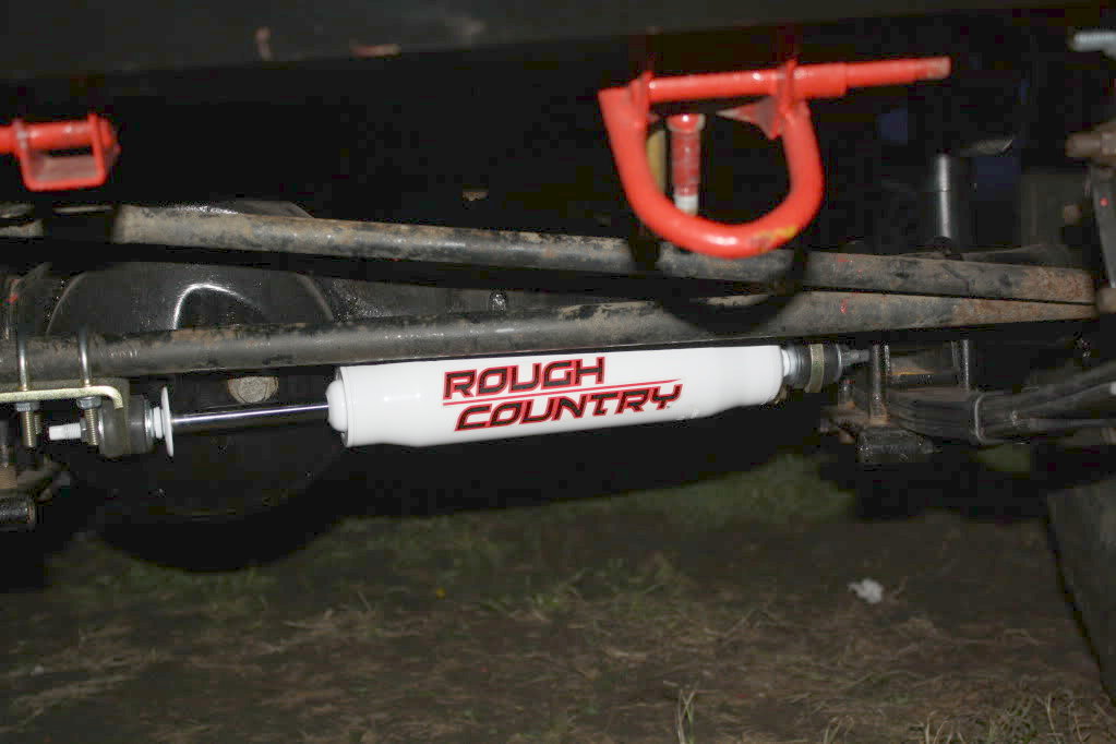

I just received my rough country steering damper kit, the kits never being fitted but 2nd hand and comes with no instructions. Could any of you point me in right direction as this is my first sj. Thanks Andy

Heres a picture of mine. Might be some help to you, the end that you cant see in the picture is just clamped on to the axle.

looks simple enough, the N/S end away from the piston what dose it attach to

Gotta bracket that goes round the axle by a u bolt if I remember correctly, the other is on the steering bar as shown

ok thanks guys ill have a bash tomorrow
