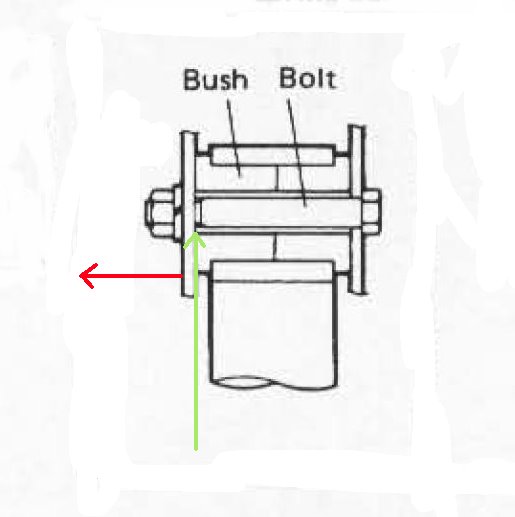

I had one bolt on mine rust into the sleeve and no heat or hammer would shift it (to be honest you cannot get the heat where you need it). I undid the nut and prized the spring hanger out a little (Quite easy not very thick) (red arrow) leaving me enough room to use a 1mm cutting disc in an angle grinder to cut the bolt off (green arrow). Then cut the bolt head off using said grinder. A bit of wiggling and the leaf spring will be out, ok you need a new bolt but there nothing special and can be purchased at any good ironmonger. Hope that was what your after :er:
Any excuse for a diagram :thumbup:
O and the bolt was rated 8.8 standard/normal strength, don't be tempted to use just a bit of threaded bar.

Darrell has got it in one, I've had to do that loads of times on various sjs, the worst you'll do is take a bit of paint off of you are careful.

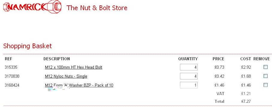

I got my bolts from these guys. Don't forget some nyloc nuts and washers.
M12 100mm zinc plated bolts 8.8

Darrell wrote:I had one bolt on mine rust into the sleeve and no heat or hammer would shift it (to be honest you cannot get the heat where you need it). I undid the nut and prized the spring hanger out a little (Quite easy not very thick) (red arrow) leaving me enough room to use a 1mm cutting disc in an angle grinder to cut the bolt off (green arrow). Then cut the bolt head off using said grinder. A bit of wiggling and the leaf spring will be out, ok you need a new bolt but there nothing special and can be purchased at any good ironmonger. Hope that was what your after :er:
