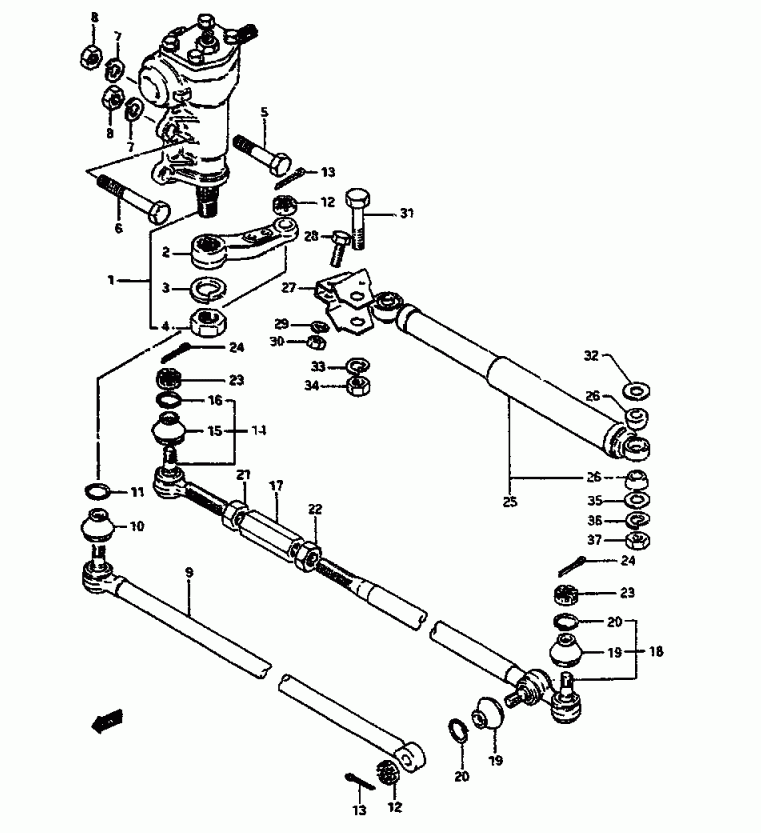

Second My sreeing drag link has a split rubber on solid end the joint feels fine can you get new rubbers or do you have to replace whole arm

You should be able to replace the rubber? Not sure where you would by the rubber separate either??
Re: Drag link and Anti Roll Bar
Post by Darrell » Tue Oct 23, 2012 9:56 pm
Had a "Google" and this company says number 1 fits the SJ !!
http://www.balljointboots.co.uk/
tie rod etc.gif (34.92 KiB) Viewed 5808 times
