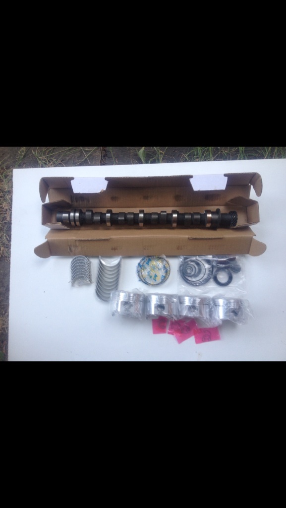

Re: Engine Rebuild Parts
Andy,
£200 mate
Pistons, rings, big ends, mains, rings, and performance long duration cam
And head gasket.
£200 mate
And head gasket.
- image.jpg (73.54 KiB) Viewed 7747 times
