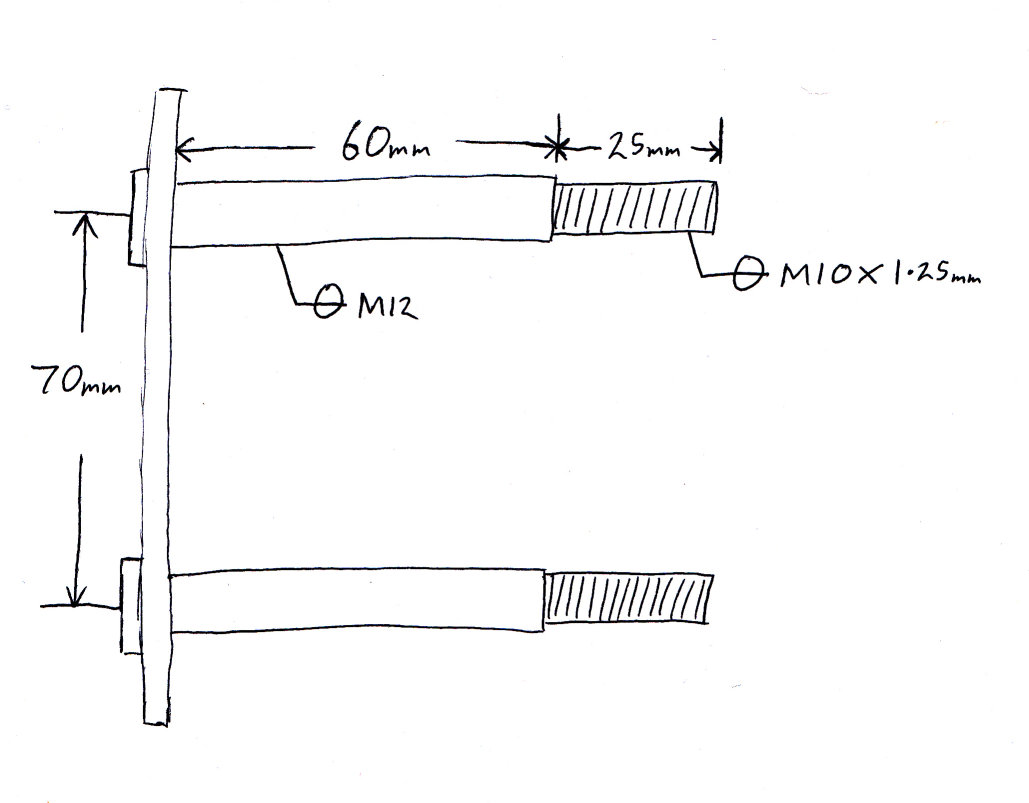

Got me some new bushes for all 4 corners. The bolt hole in the bushes is 12mm wide but the original bolts are 10mm thick measured at the thread poking out currently. I'mggoing to be making new shackles so wa swondering if it would be best to go withthe original size bolt, or switch to 12mm bolts? I guess bigger is better but maybe there is a reason for having them at 10mm?

They are actually 12mm. The original shackles bolts are stepped so they can be tightened up fully and not compress the bush.
Diagram I did when mine was in pieces.......
Standard shackle bolts.jpg (85.32 KiB) Viewed 5021 times

Your diagram looks just like mine so that's good news lol. I see about the stepped size there. I'm going to go with new bolts all round. Cheers for the reply mate. :)
