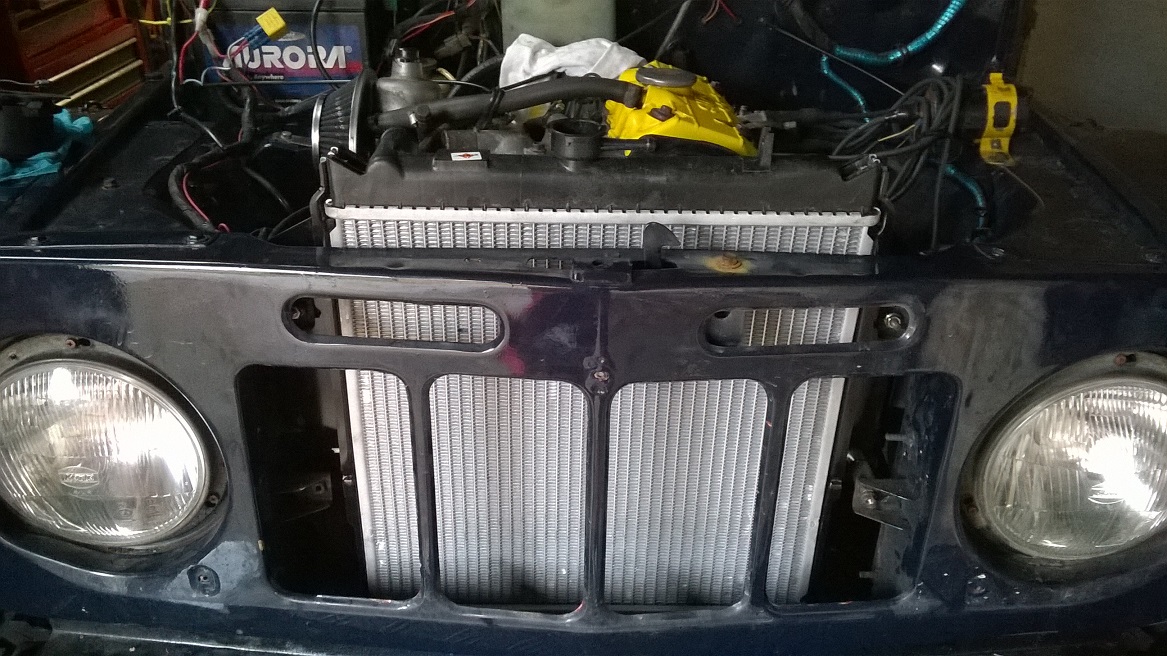

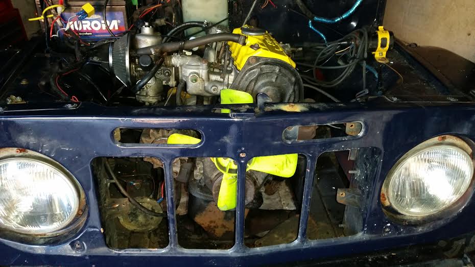

Got the radiator out, and the SJ replacement is a bit too big. Not a chance of getting an LJ one so it will be, err, 'adapted' to fit. And yes the viscous fan is coming off to be repainted!

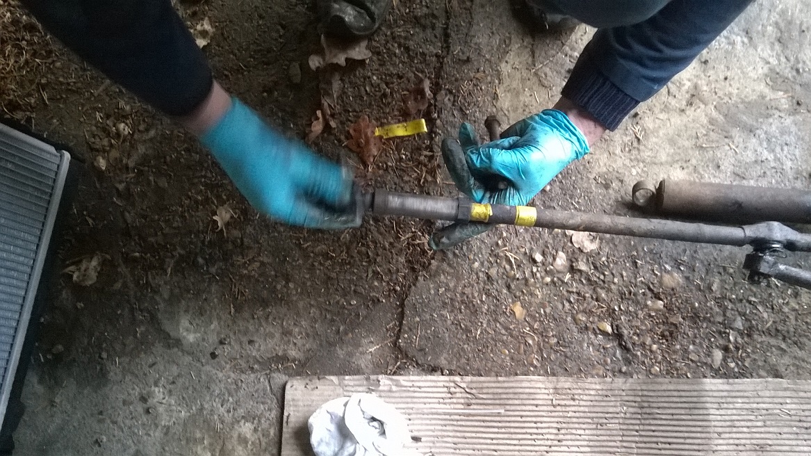

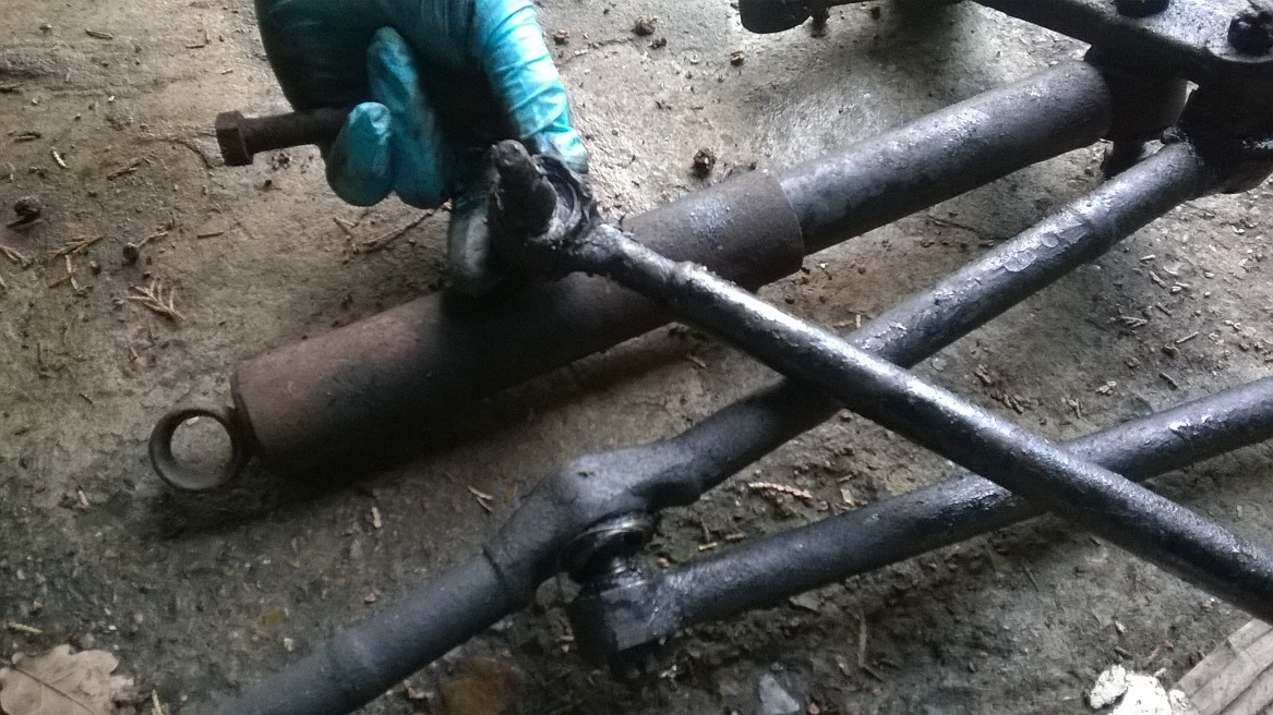

Loads done today, horn is now on the dash, gave up trying to wire it through the steering wheel (which won't come off...the wheel does but the boss won't so it's staying put!). Front brakes are done and now doing the rears, brake shoes look like new so they can stay. Made some spacers out of billet and now the 410 rad fits...just. It looks in the pic as if it's too high but the bonnet does close ok. Then came the nightmare. All the steering is (in mechanical terminology) shagged. Some of it was gaffer taped together, everything is worn out. Called Dave at Llama, who put me onto someone else and then someone else until finally we get to Rhino Ray. He can fix it all but at a price, £200+. I'll box it all up and send it to him I guess...no choice really. It's all original LJ stuff and impossible to find. On the plus side it has all new poly bushes so I have a complete brand new set that came with the car! The fan belt I was guaranteed would fit didn't...of course, so I took the old one with me and got the right one. Hoses arrived from Malta but there is a custom charge so I will go pick them up tomorrow. Door seals were on my doorstep when I got home, and I finished trimming all the door cards too. Got new plugs, leads etc to do a service. Old plugs were ok but...old.

£200 seems steep - no way an SJ steering bar would fit?

I have LJ steering stufffffff! Save your money and have a chat to me :thumbup:
Also Apparently the lj ball joints can be removed and changed using sj balljoints And there is a way to use sj410 steering links but the pics have gone :thumbdown: http://auszookers.com/forum/viewtopic.p ... 69&start=0
