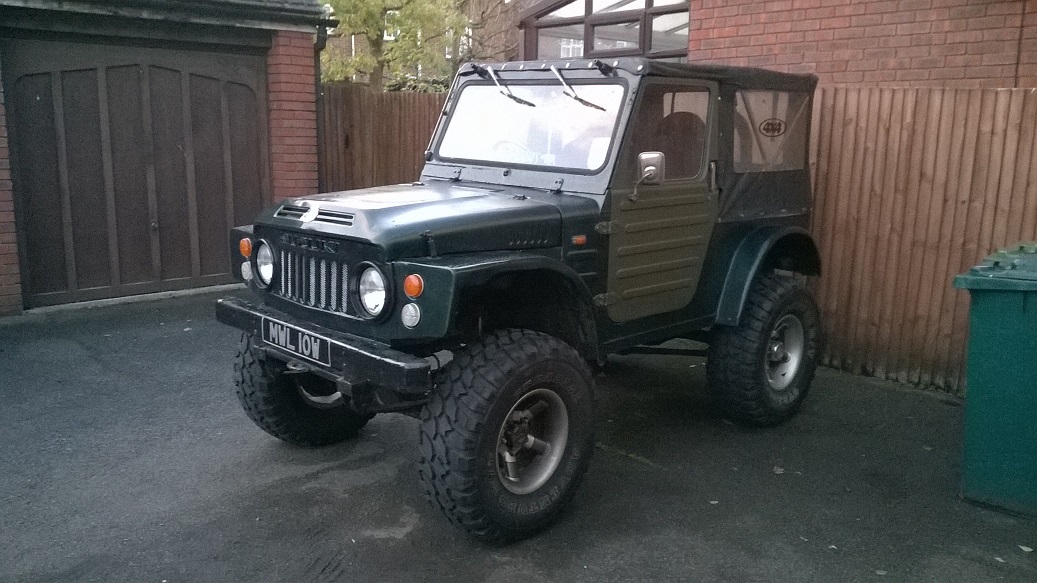

OK. Either I'm a complete moron or have an eye for a decent Suzuki. I bought another LJ. Don't ask where the money came from, suffice to say my Vitara will be up for sale very soon

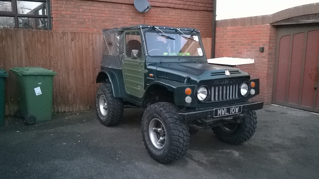

This was on ebay and I drove down with my mate Stu (again) to look her over in Dover. Fast drive down...not a fast one back! She is amazingly clean underneath..no rot at all and no underseal hiding anything. Vitara 1.6 weber carbed engine, SJ413 gearbox mated to a 410 tcase. Procomps all round (sigh, rears leaking a tad) running Vitara axles with coils on the rear and SPOA up front. 33" new muds all round and new wheels. Bucket seats with harnesses, a stereo that doesn't work, a load of spares including an engine. Brand new roof but it has no fasteners so that will be sorted and put on at a later date. Brand new MOT with (get this) NO advisories! So a deal was done and we set off home.
Got through a tunnel leaving Dover, cliffs and a shear drop on my left and WOAH! The wind hit me and I had to steer like a lunatic over to the right almost hitting a Smart car, this was getting scary. The 100 mile drive took 3 hours with 2 rest stops to calm my shattered nerves.

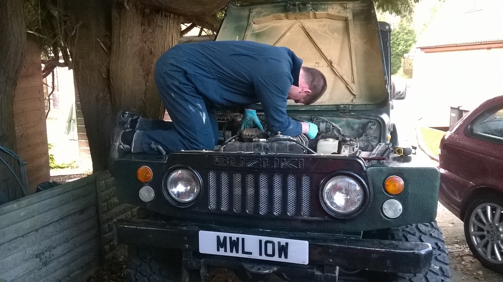

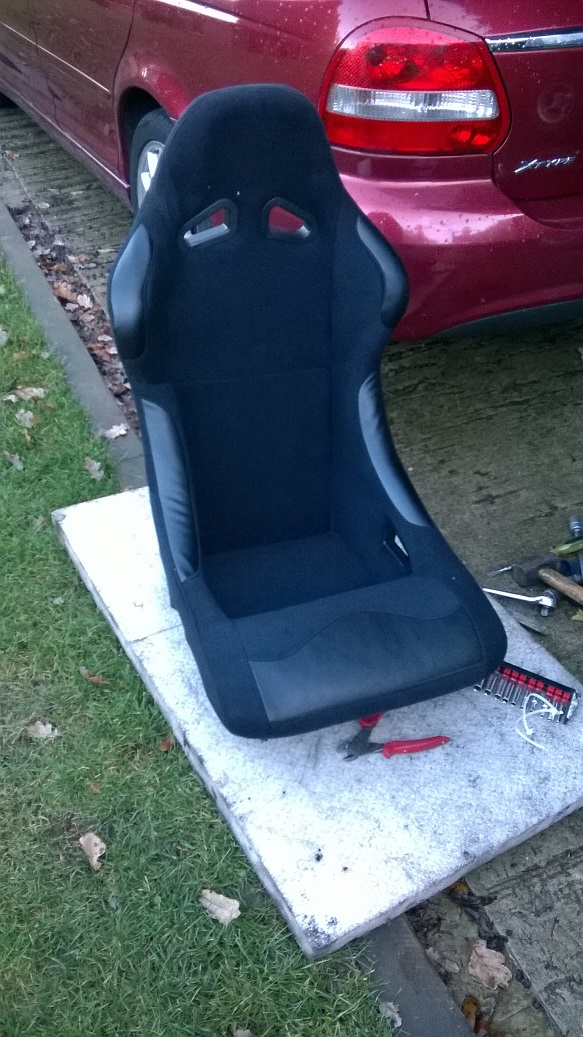

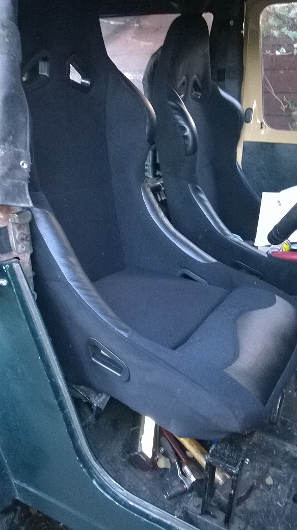

We finally got home and the first thing was a damn good service. She was running lumpy, so new dizzy, rotor arm, plugs, (need leads), air filter, oil and oil filter and a lot better. The carb needs stripping down and cleaning. Rear brake shoes are shagged. As are the seats and new ones have gone in after a bit of welding. 1 tbox mount is knackered and 1 engine mount, ordered those, then kicked myself as the spare engine has 2 engine mounts, both excellent. Git.
So this is my daily drive now. At 6ft 3" tall it gets noticed a bit. I've already seen people taking photos of it and three people have asked me is it for sale.

Woah. Love LJ's! Apparently so do you!
What's the front axle from?
One of the first things I'd do if that was mine would be to get rid of the z bar and do a high steer conversion - z bars can be a problem. Bump steer etc.

That's on the list...it hates speed bumps. Front axle is a Vitara. Is is Rob Stoor who does the high lift kit?
But bumps or no bumps she is a hoot to drive!
Re: the no dosh LJ revamp
Front axle will be samurai or 413 with a vit diff.
