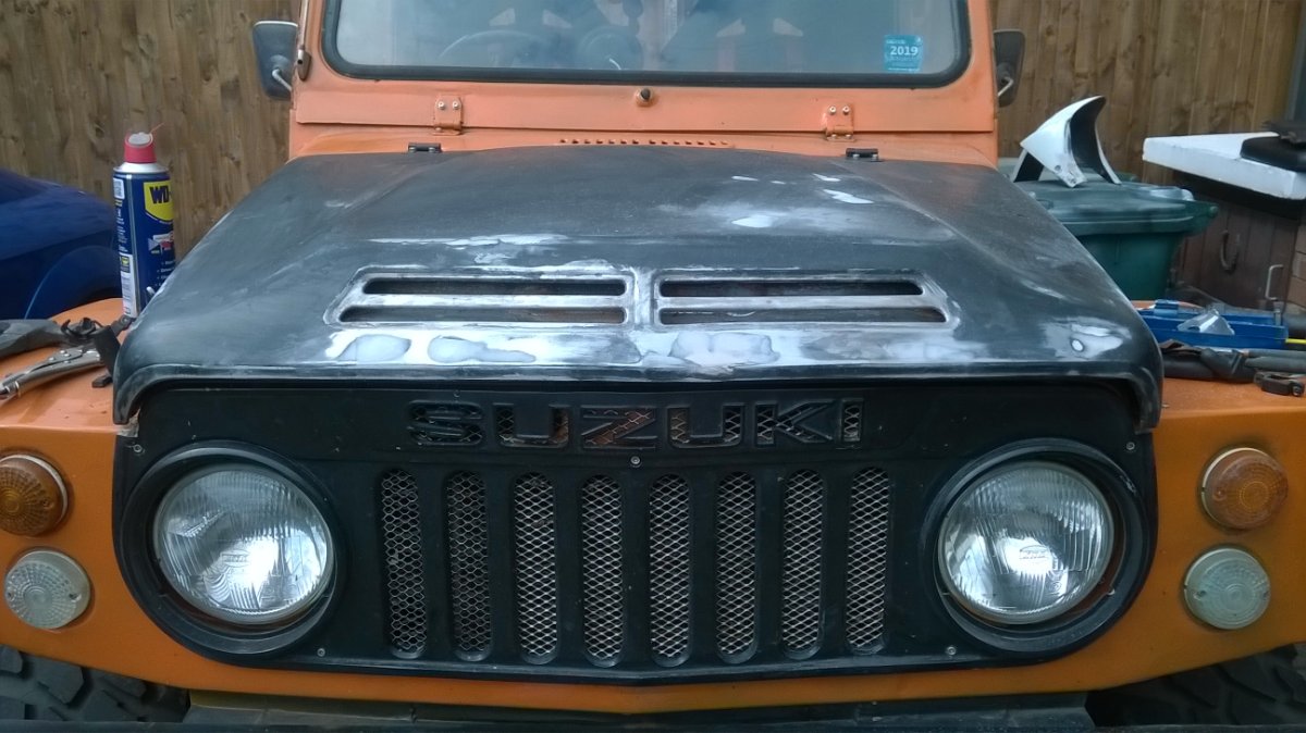

Post by donkeychomp » Fri May 03, 2019 10:28 pm

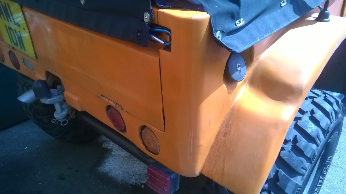

Rear quarter fixed...

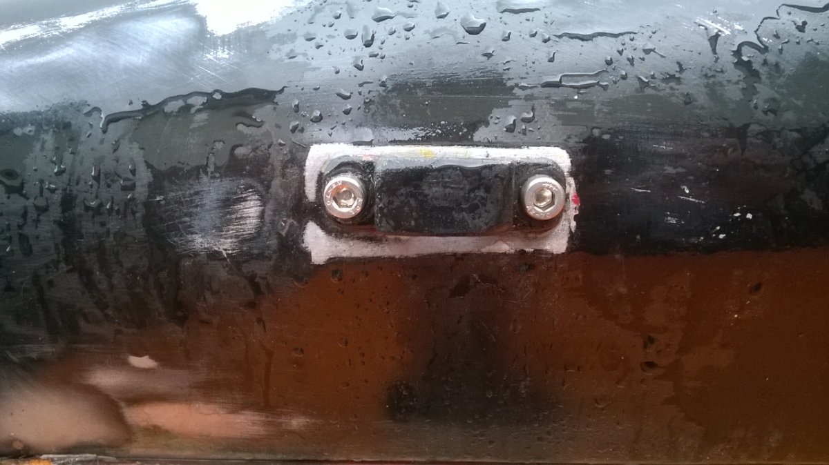

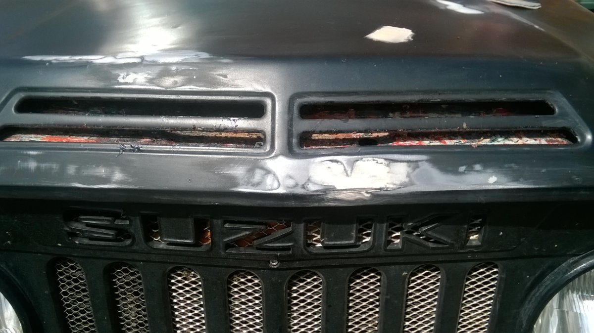

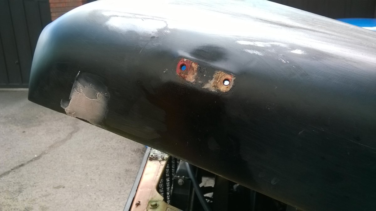

Then, rather rashly, I decided to tackle the bonnet. It's always been a bit lop sided but some twisting sorted that. Then tackle various dings.
The screws holding the clips where fused solid so a lot of heat and they finally shifted. Used Allen bolts to put 'em back on. Was hoping to paint it today but the heavens opened up!
If it's dry tomorrow I'll finish it. Expecting another hot summer so this time every panel is going to get a damn good seeing to. Cut out any rust and weld fresh metal back in!

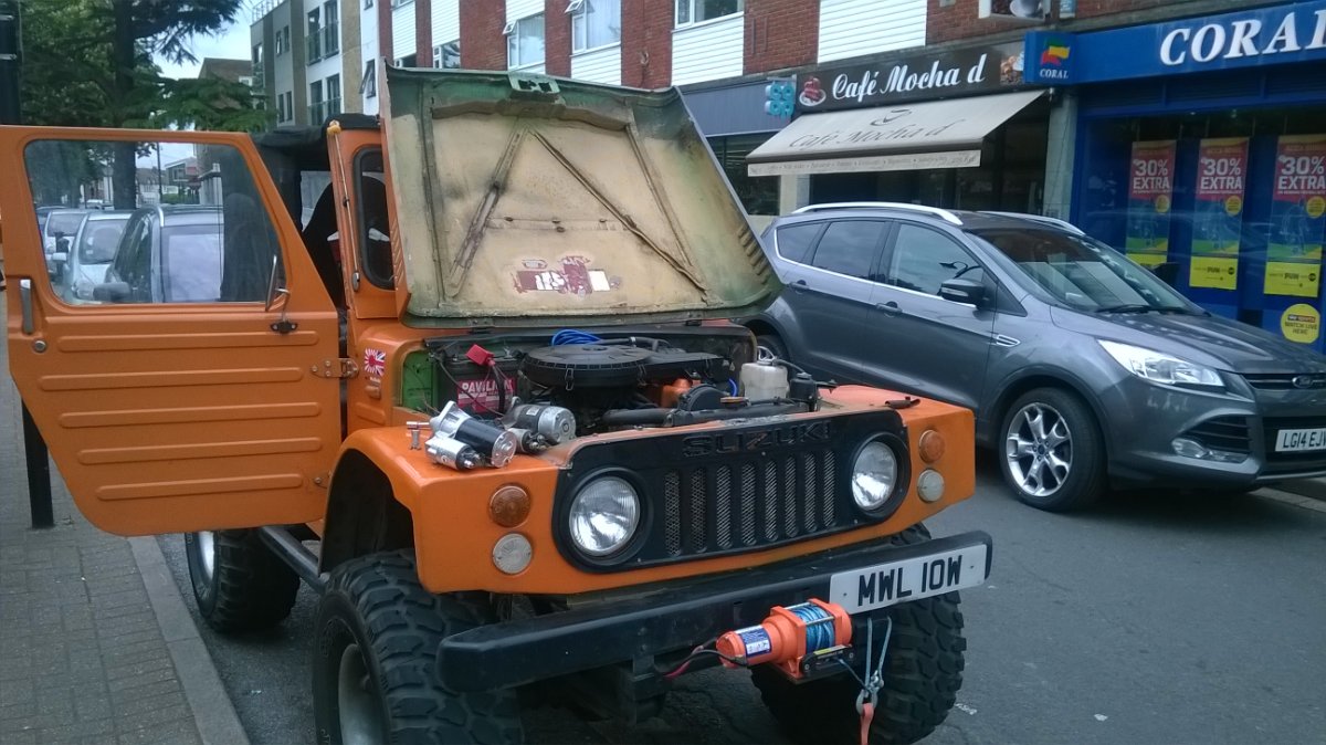

Post by donkeychomp » Mon May 20, 2019 10:15 pm

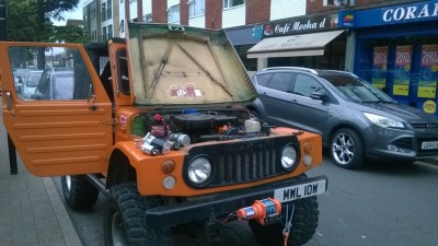

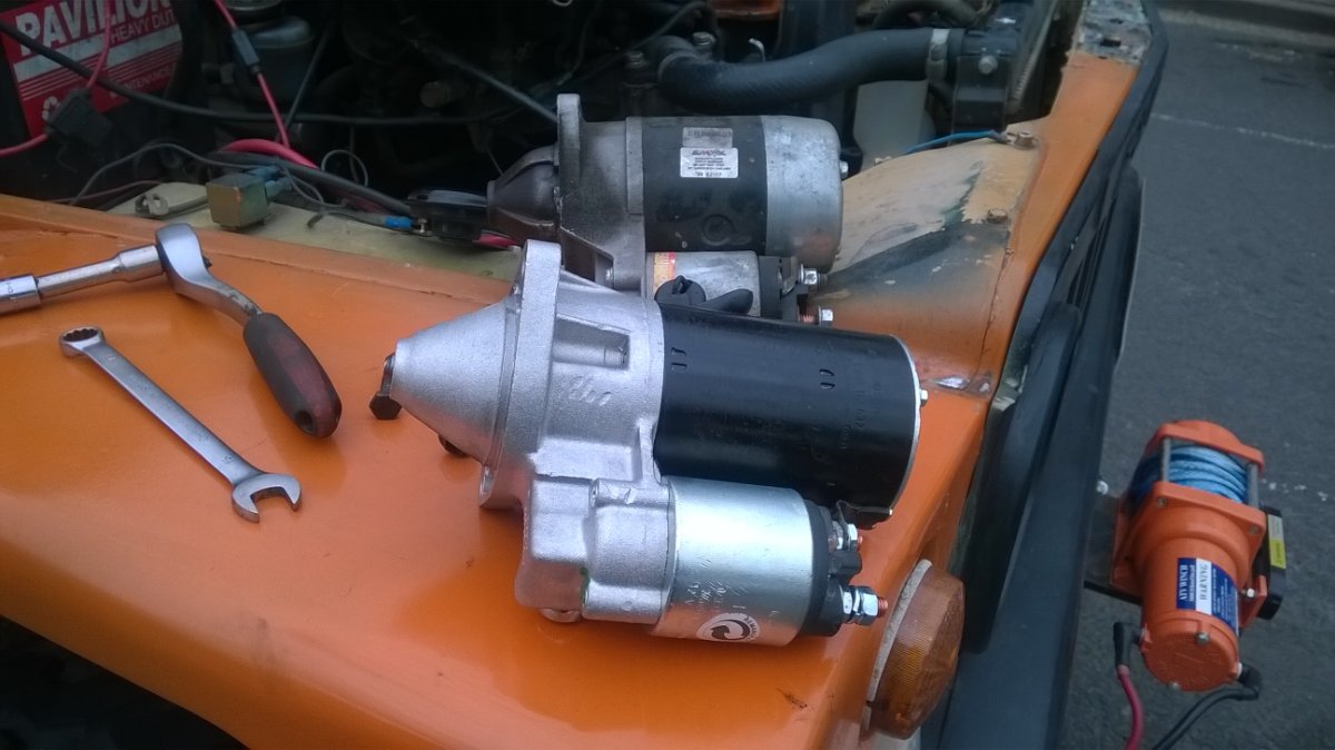

I have found a prop. Rear one I think but I am hoping the engineers can do a cut and shut and make a good middle one using both. Was hoping to do that today when disaster struck. Starter motor packed up, I could see the solenoid trying to push out of it's mounting when I tried to start it. Local place ordered a new Lucas one (so vastly superior to the manky one I had) at a cost though. £169 exchange. So that's the prop money out the window along with all the other bits that need sorting. Bollocks. Had to fit the thing on the High Street accompanied by the inane chat of passers by. 'Wotcha doin' mate' etc. What the feck do you think I'm doing?? :poke:
