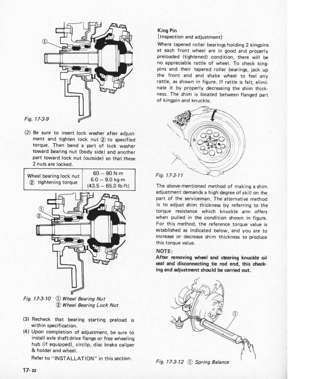

Hi guys, I started disassembling my front axle to rebuild it. I understand how the correct wheel bearing preload has to be set, but how do I know how to shim the kingpin's? do I start by using no shims anywhere, and go from there, or what is the recommended procedure?

I would start with 1 shim in each kingpin, do it all up and measure the kingpin preload, then remove shims to increase preload, or add more shims to decrease preload...

good to know twiss! only thing now is to find some more shims, as I think there are only 3 shims on my axle. what's the easiest way to measure the king pin bearing preload?
Re: rebuilding front axle
Post by Darrell » Wed Dec 17, 2014 7:37 pm
Guess it ;) or use a spring balance.

Personally I would put the original shims back in the same places and see how it is.
Chances are nobody ever removed any to tighten up worn bearings.
