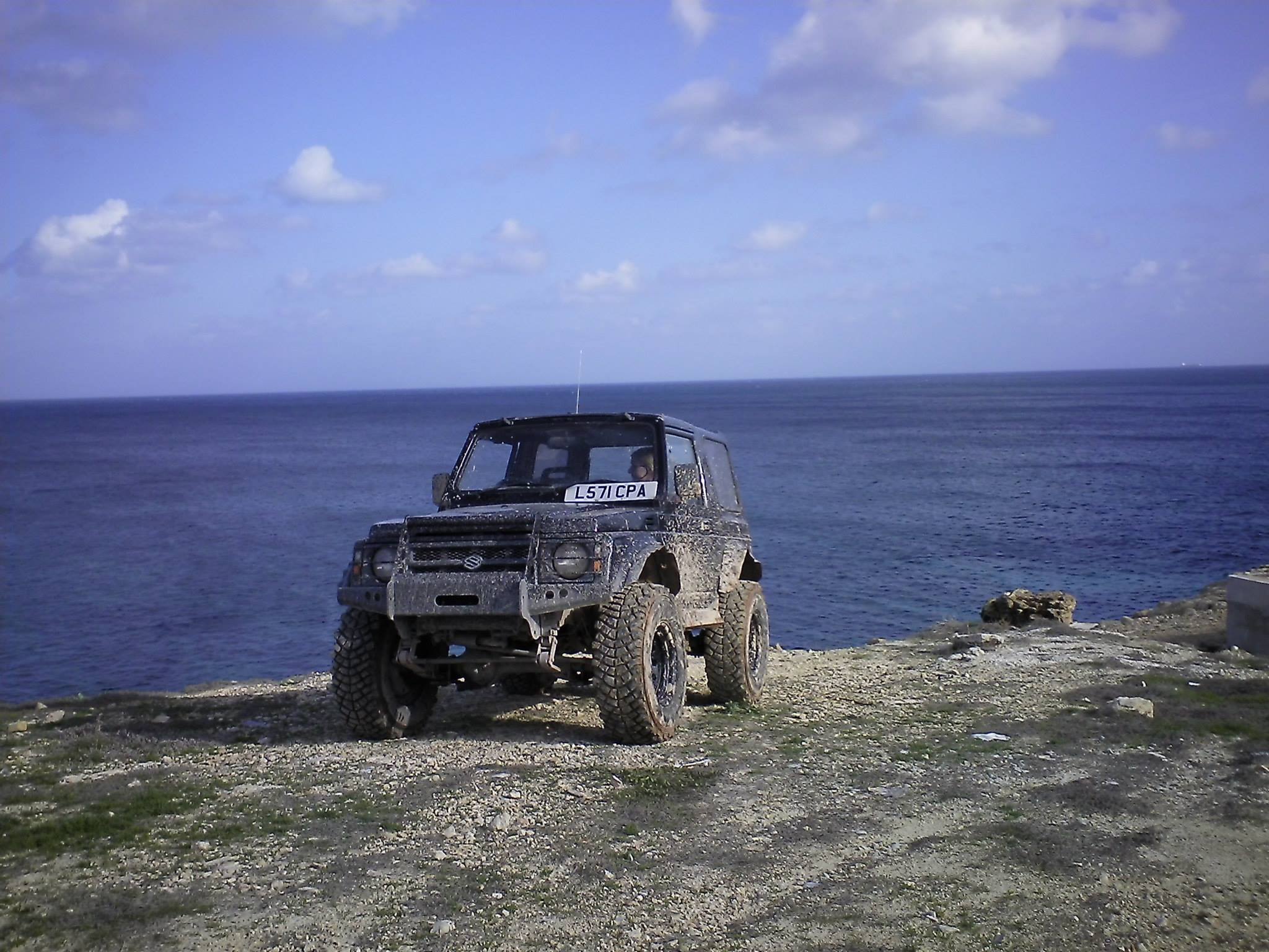

My samurai with 2.5" lift and virtual lift + 31s
- 10862655_10202880133555592_2136707667153623718_o.jpg (333.61 KiB) Viewed 9006 times

I ran 31s just with a VL with no problems. All on standard suspension.
