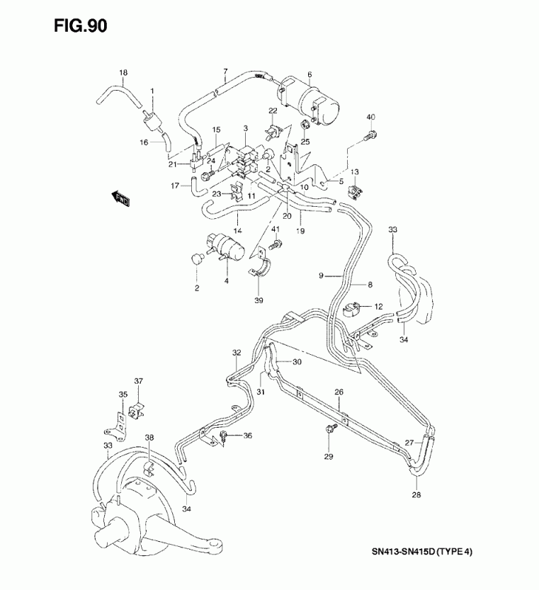

There's a set of unused lines/pipes on the front axle of this Jimny my friend Scottie has been looking over for a friend, and he's asked me if I know what they're for.
I don't have a clue - anyone here know?

Vacuum for auto free wheel hubs?
Poss swapped to manual hubs by someone in the past?
Just guessing though.

Jordi wrote:Vacuum for auto free wheel hubs?
I believe your correct :thumbup:

Ah, yes - that makes perfect sense!
Thanks guys!

Apparently the 4x4 light wont work if they arnt blocked off

I take it that there are Manual Hubs fitted?

I haven't seen the vehicle personally, but Scottie told me this morning that there are no freewheeling hubs fitted, but 4x4 still works - so I assume it's got flanges.

Yup. That there, I believe, is a hub flange.

Always locked then? If Im correct in thinking?
