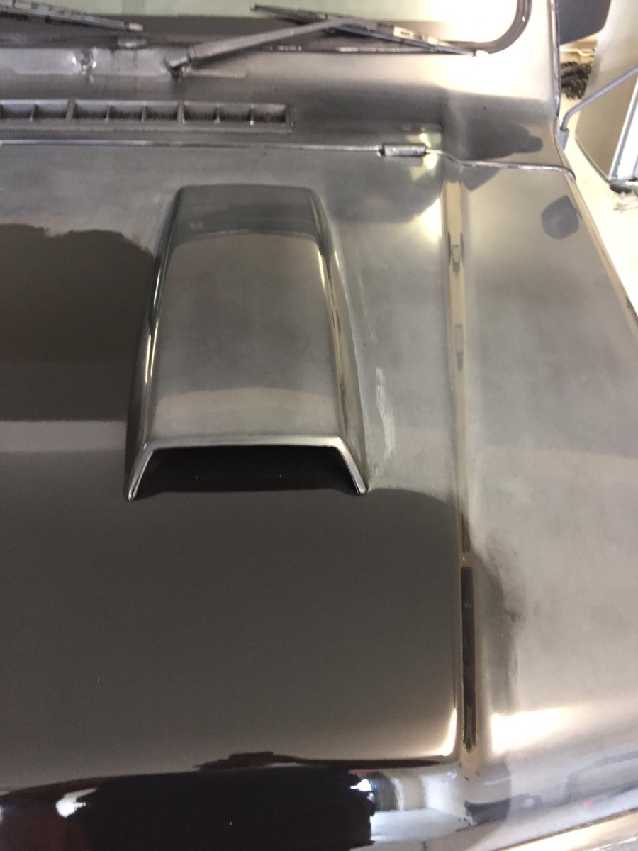

fella
Posts: 16
Joined: Wed Feb 06, 2019 12:57 am
Re: 1998 Jimny Japanese Import
Post by fella » Sat Jul 27, 2019 1:43 pm
There are a bfew more pics in my intro newbie thread.
Here's one new pic from the detailer who is giving it a once over for us!

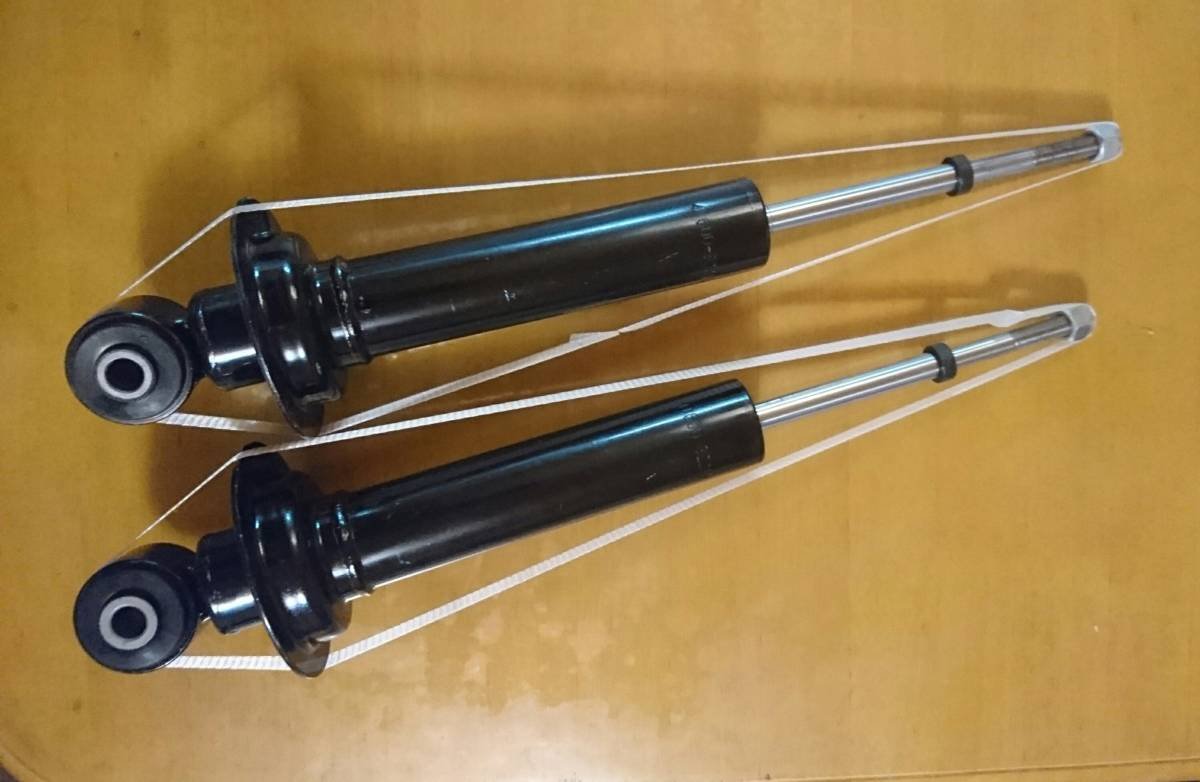

Post by fella » Tue Oct 01, 2019 10:23 pm
we have a v5c and number plates. still haven't seen it with our own eyes since march in Japan!
we have had a set of sj steel wheels powder coated gloss black and have some crap a/t tyres on until we can get it lifted and then fit some nicer bigger ones! still, it saves the alloy 16's and snow tyres for the winter.
its with a more modifying specialist garage now to look at fettling the boost and a gauge to match, piggybacking the ecu to delete fuel cut off and allows the higher boost, fit a bypass valve to keep the boost on tap, sort the rust blemishes out and some intake/intercooler mods.
Lifting is highest on my wife's priority list, but it is proving to be a bit of pain, its supported hardly at all in europe. the sj80 sold in tiny numbers in eastern europe so its nobod stocks any kit for it. the front and rear springs wouldn't be too tricky as neither would be the rear shocks. the difficulty is the front shock runs seats the spring on its base, but not on the top so its halfway to a very skinny coilover. alas for something correct and guaranteed to fit the places to import from are either japan or aus,
aus is easiest as no language barrier, but the shocks and springs are designed for the heavier 4 pot engines (maybe not such a bad idea as we always travel pretty loaded with ski snowboard kit or mountain bikes etc.
the japanese ones are obviously completely correct out the box, but much harder to arrange export for such a heavy item, are a good amount more expensive before the postage which from experience is also really expensive to arrange out of japan.
in a bit of a quandry and am still waiting for a few more companies to get back to me before i have to choose! if anybody knows of anybody who has been in this situation or knows somebody who could, let me know! a picture of the unobtanium part see image!

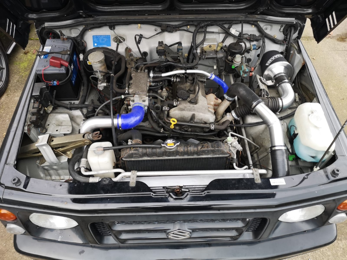

Post by fella » Wed Nov 06, 2019 12:21 pm
Couple of pictures from the garage. It makes all the sounds and has amazing turbo chatter! Not sure how to load a video unfortunately.
The next thing to allow us to finetune it to how we want, is figuring out a piggyback/standalone setup to manage it all.
Get to see it on Sunday at long last.
Posts: 3859
Post by Anton » Thu Nov 07, 2019 2:54 pm
Twiss is using a megasquirt setup to manage his turbo/supercharged setup. I think you can buy off-the-shelf setups.
