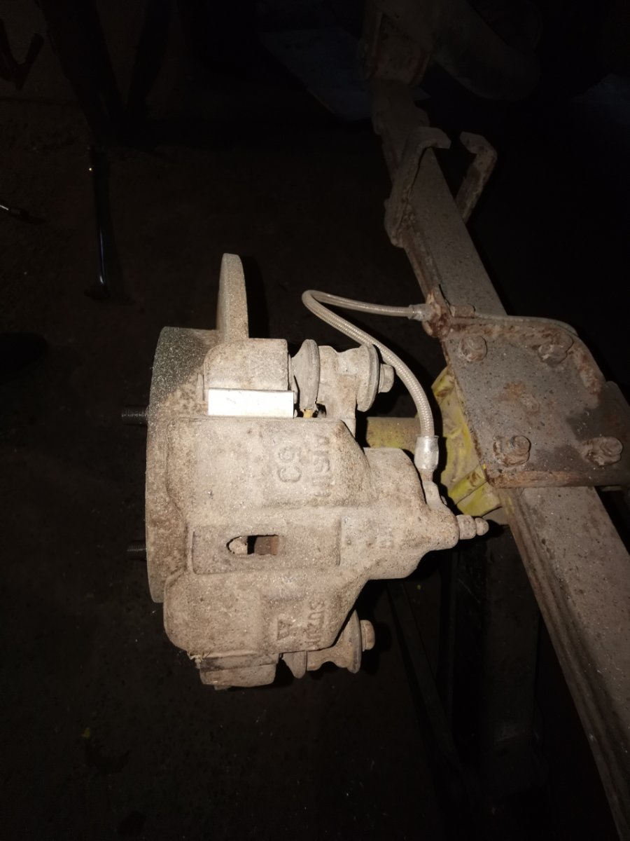

Re: Calipers
Still Stuck, New calipers are a fortune, can get some Jimny ones cheapish but without the Holders dont want to order them to find that they dont fit my Holders here is pics of whats on the rear, I have Jiomnys on the front.
