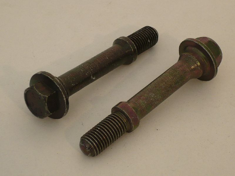

Mine is fitted with the original bolts. You can start them with no spring compression and wind them in until they reach the flange. At this they also have the correct compression/tension.
Exhaust manifold bolts.jpg (70.39 KiB) Viewed 5841 times

I guess you don't have the original bolts so I would use a socket and extension from under the vehicle.
You can put a loose nut or 2 into the socket so as to stop the bolt head from entering the socket too far.
