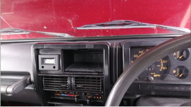

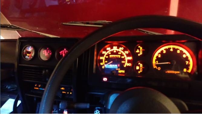

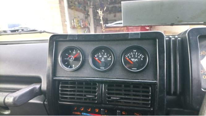

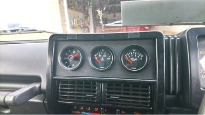

Gave up on trying to make the temp gauge work and did this instead to go along with the OP gauge and clock I had been wanting to fit.
Broken LCD clock has to go .

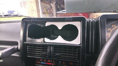

Make a  blanking plate.

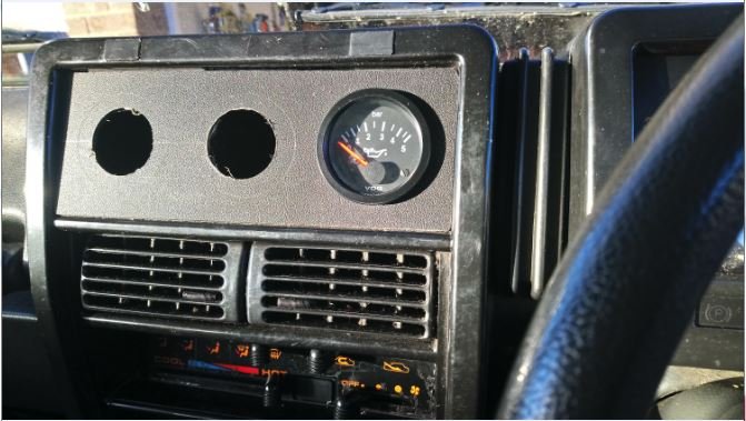

Find the centres.
Find the centres.

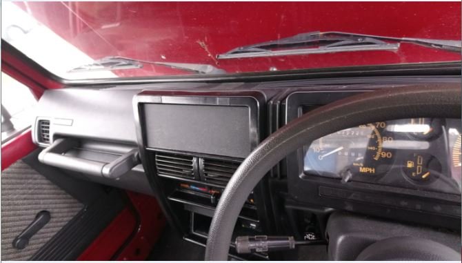

Make a back spacer to keep the front panel flat.
Fit the gauges and wire them up.

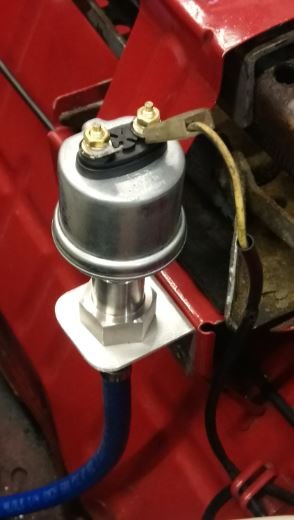

Remote OP switch to get around the BSPT - NPT issue.

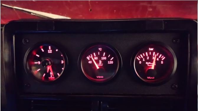

The temp sits about 82 when warmed up.
150ohm resistor fitted to stock gauge to make it read.
