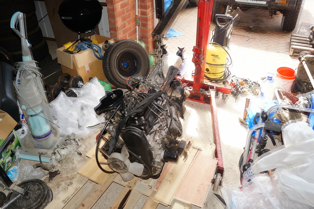

The engine swap is getting there now, the old engine is out, the gearbox has been seperated and pressure washed, just got to put it all together again now.

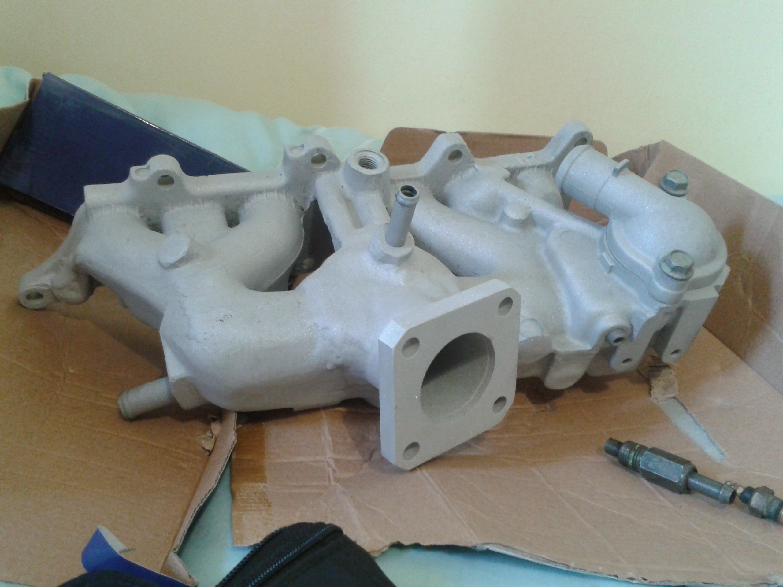

My su manifold turned up today, so I'll be cracking on with the rest of the engine change this weekend

Re: Lazy's samurai build
Post by Edweird » Sat Sep 08, 2012 1:34 am
Nice looking manifold. Is that a Rockwatt? It looks fairly well port matched to me.

Yep that is a Rockwatt manifold and it's now fitted with the SU attached.

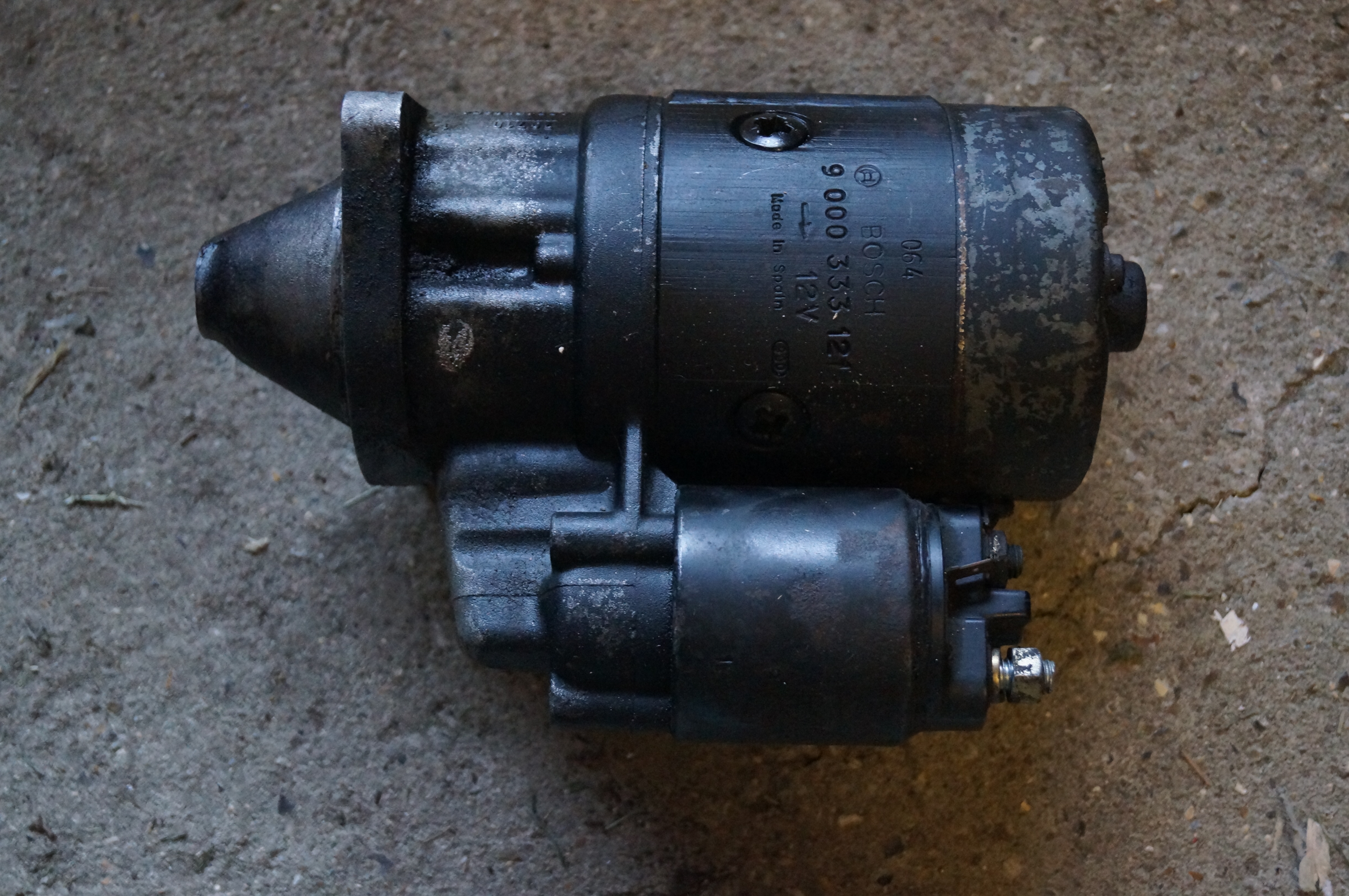

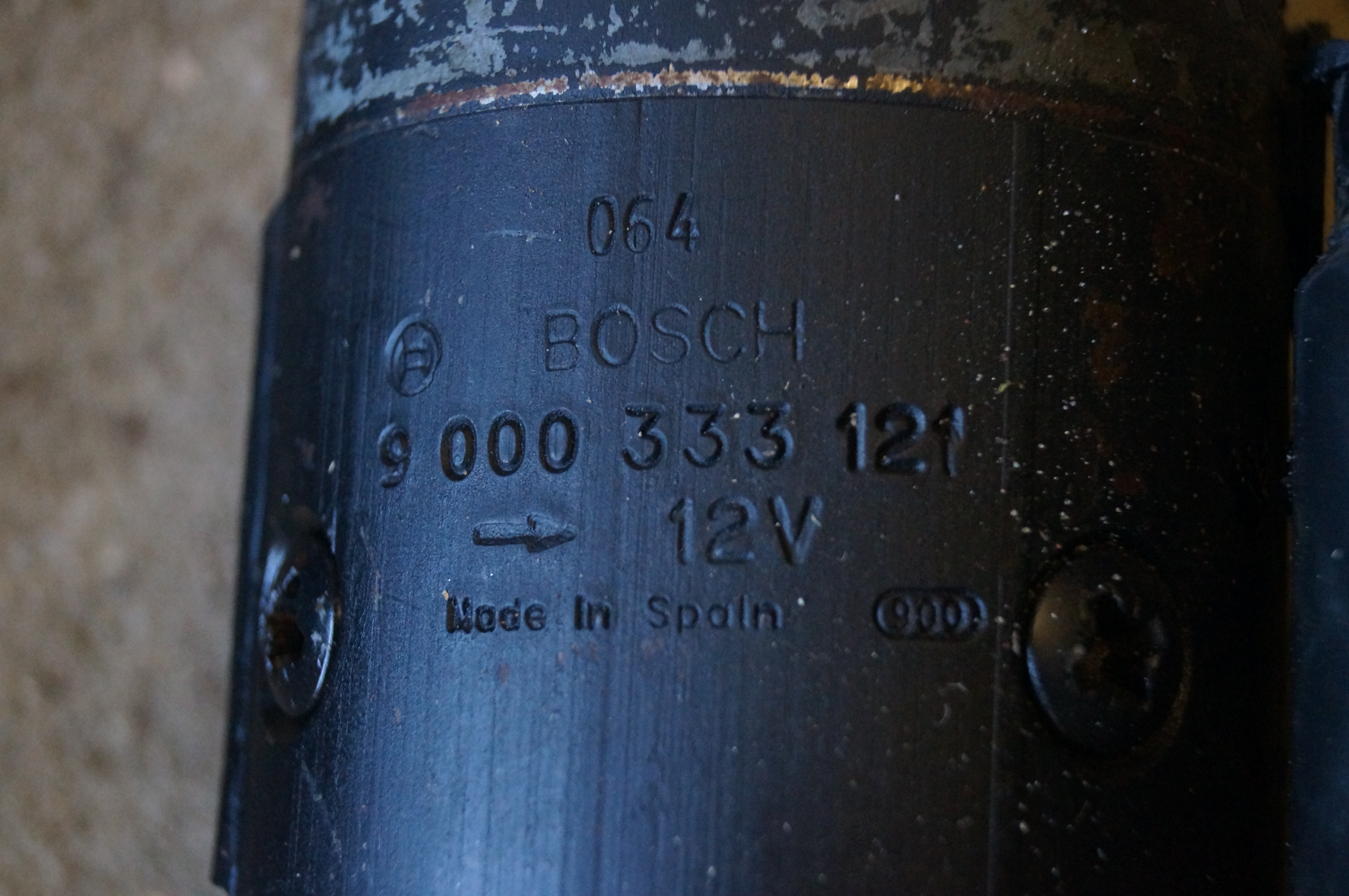

Also how can I tell if my starter is a skinny one. I've 'offered it up' and looks like it will only just fit. How do I make sure it's the right kind, after seeing ScottieJ's post in another topic (can't remember what one) I'm not too worried if it's not.
Post by dan_2k_uk » Sun Sep 09, 2012 12:06 am
From the look of the previous photos when you removed it it looks like a rather fat one to me.
Post by ROBBIE » Sun Sep 09, 2012 3:28 pm
Looking at pic DSC01092.JPG I would say thats a fat starter

This is my current starter.
Now a build in progress
Post by dan_2k_uk » Sun Sep 09, 2012 7:55 pm
Thats a fat one dude.

I managed to find a skinny starter on ebay so that solved that problem.
