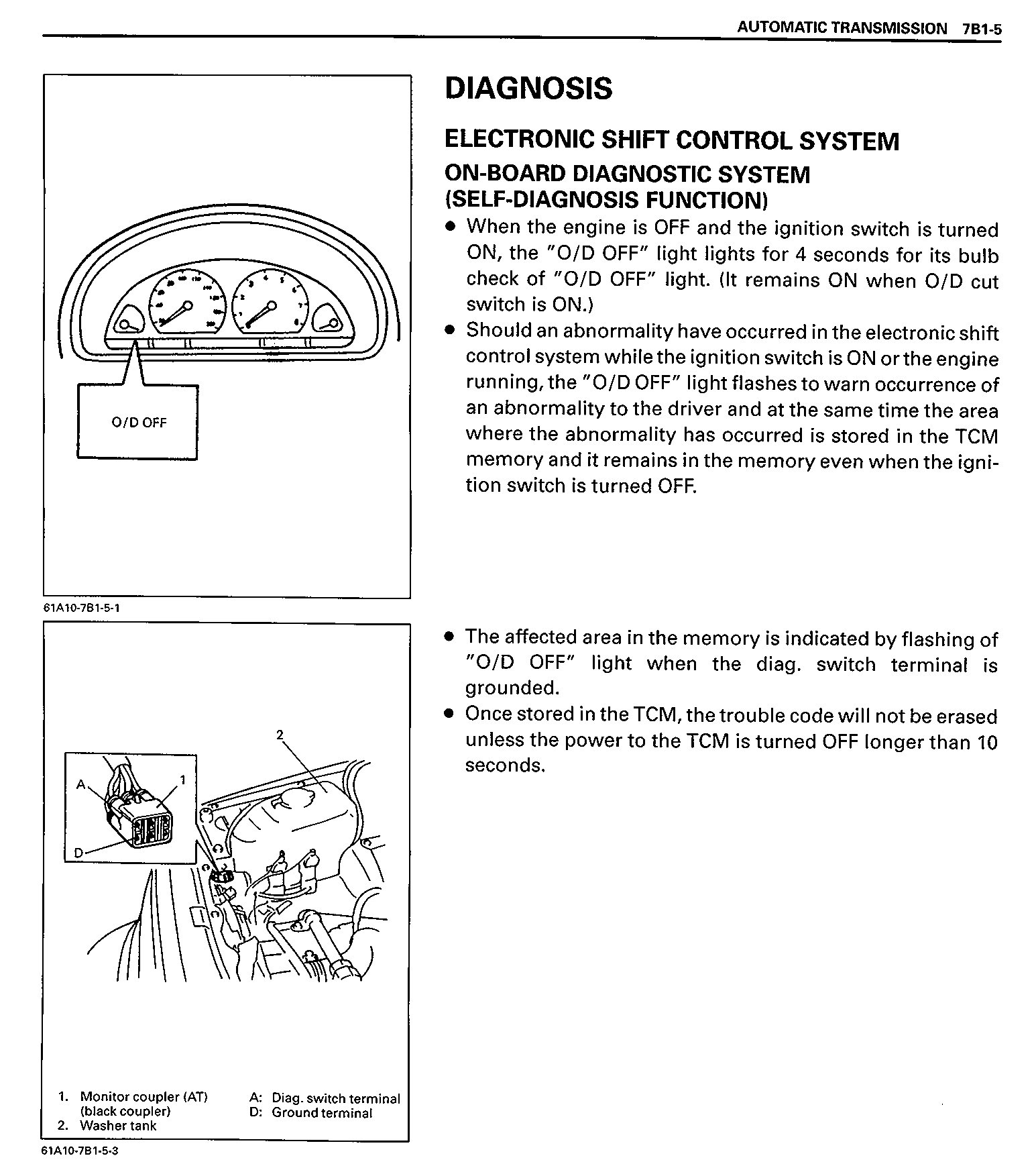

Post by Darrell » Sat Feb 14, 2015 11:38 am
Right I think this model is the SV620, so I had a look in the workshop manual and from what I can find 4th gear is referred to as overdrive. Can I assume with overdrive switched off it will only go to 3rd ??
The warning light sounds normal, with no error codes :thumbup: :thumbup:

Post by Rhinoman » Sat Feb 14, 2015 10:27 pm
Yes it a 3-sp with overdrive/4-speed depending on which particular piece of Suzuki documentation you happen to be reading. There is no OBD2 on an R reg, the TCM does have its own diagnostic port but you can pull codes using a jumper similar to how you pull codes from the engine ECU. The FSM for the SV620 can be downloaded here:
http://www.rhinoman.org/manuals/vitara/SV620.zip
The TCM should be similar to this one:
http://www.rhinopower.org/ECUs/TCM_57B40/TCM_57B40.html
