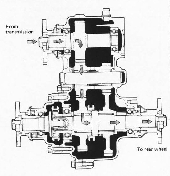

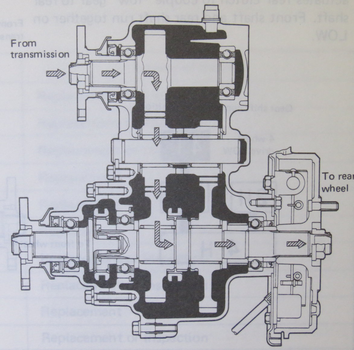

Looking at all the pics I have, they all show the transfer boxes to have the threads/fixings for the drum backplate. I assume you can swap any about (but I don't know for sure).
From the online manual
from online manual.jpg (94.23 KiB) Viewed 5806 times
And a photo from my workshop manual
From my manual.JPG (208.63 KiB) Viewed 5806 times

Yes they all SJ tboxes are tapped for the tbox handbrake :thumbup:
