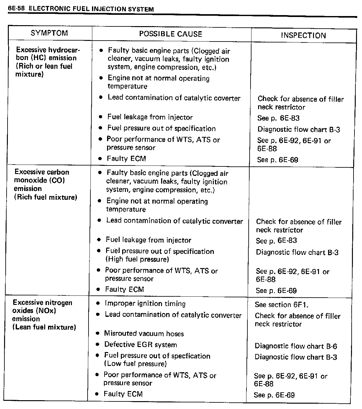

vit dia.jpg (397.74 KiB) Viewed 6433 times
