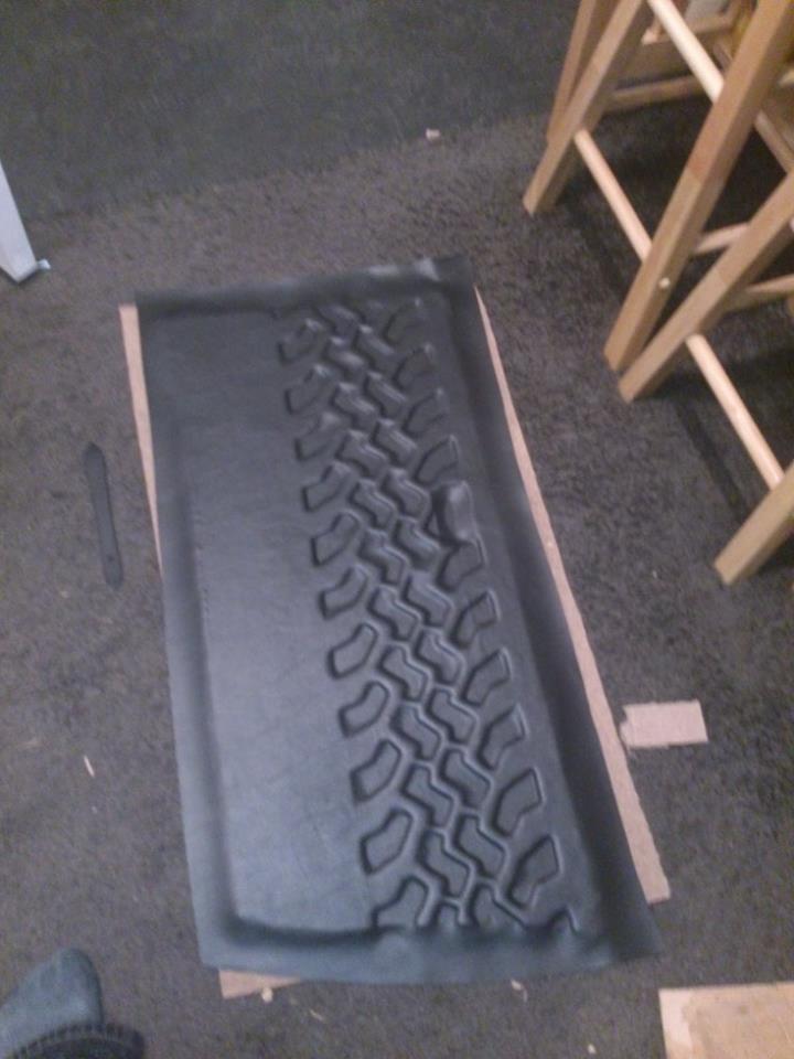

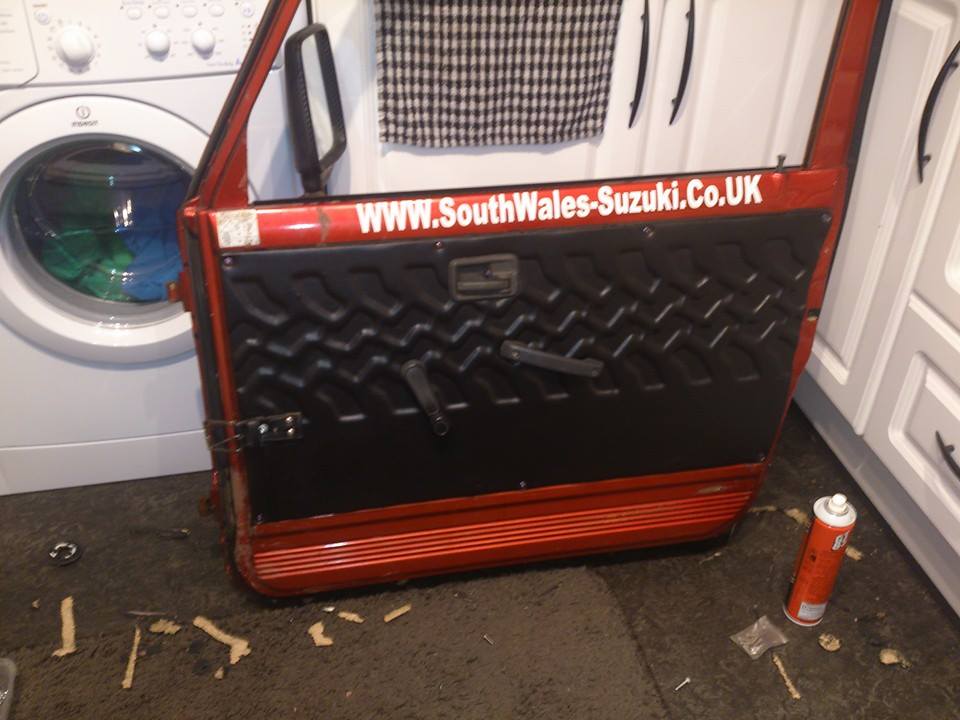

:smokin: not too shabby if i do say so my self ;)
they cost roughly 25pound to make and i had enough material to make some cards to go on the rear quarters too but i didn't put a tread pattern in those

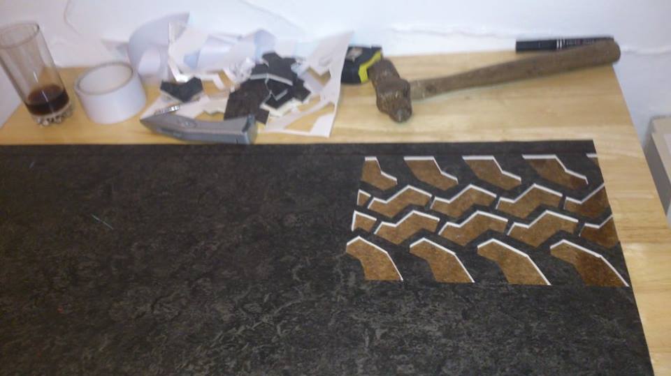

that is soooo cool mate, love them. did you use a mold for cutting out the tread pattern?

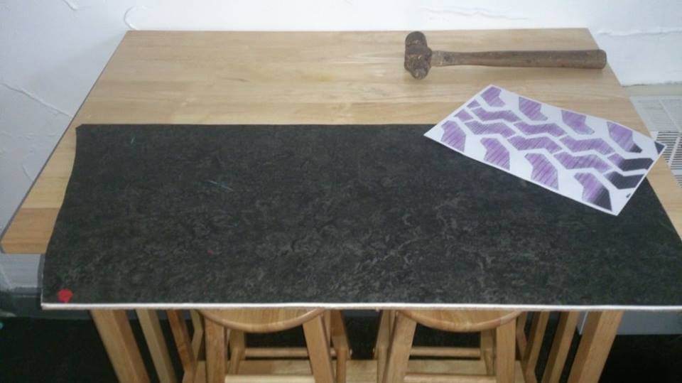

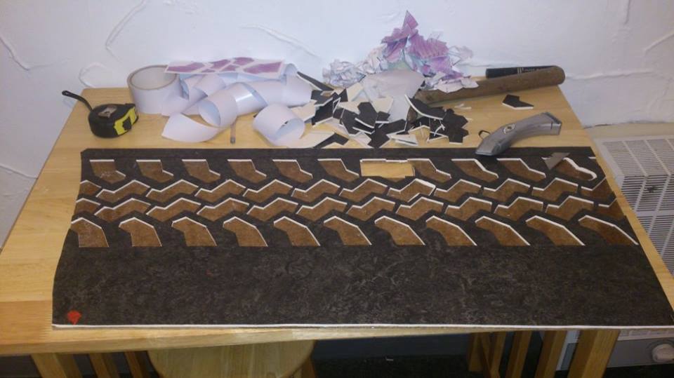

i just used double sided taper to hold a pattern down i printed on paper and just cut it with a stanley knife . . . i used an off cut of lino/vinyl flooring to cut the pattern into :smokin:
pretty easy to make a pair of them in a night unless you use spray glue thats a bit crap :| . . . spread on contact adhesive works so much better :guns:
