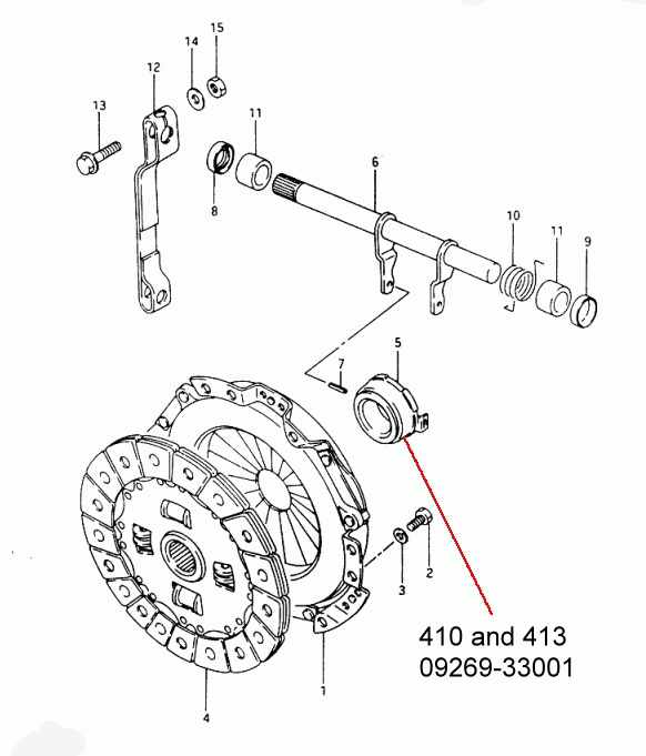

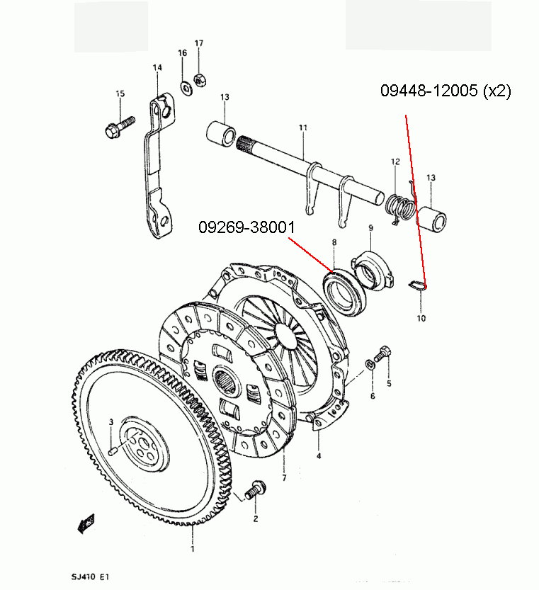

I've posted this up before (but can't find it) so..
Early 410 clutch bearing.jpg (86.41 KiB) Viewed 5447 times
Later 410 & 413 clutch bearing.gif (38.93 KiB) Viewed 5447 times

I don't know how I can re attach the bearing to the forks? Any ideas
Re: Release bearing
Post by Darrell » Sun Feb 09, 2014 4:55 pm
What's broken/missing on yours.
Is yours the early or later type.
The early spring clips are prone to breaking I've read..
