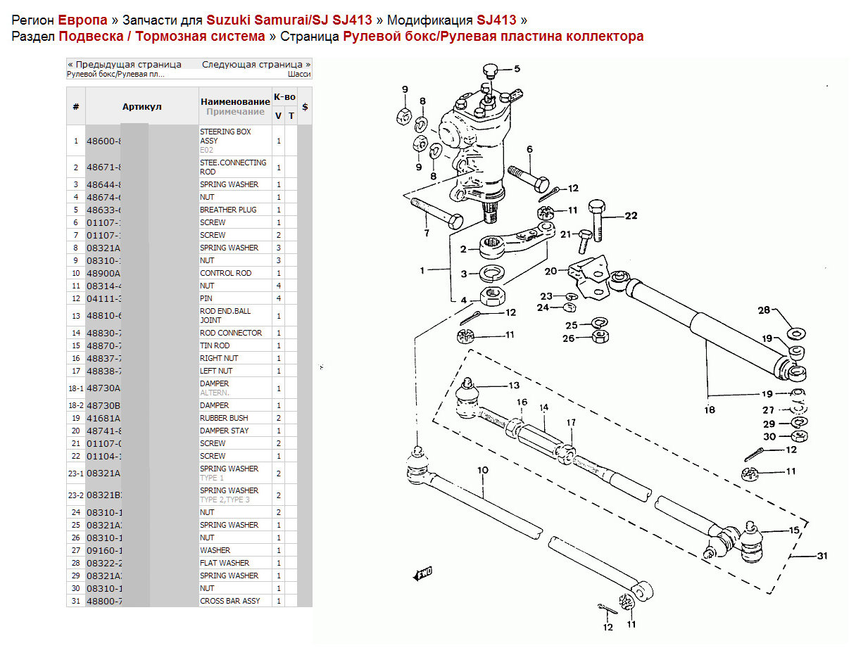

In the past this was the only site I found selling steering rod and ends.
LHD and RHD , SJ (narrow) Samurai (wide) , so you would need to careful to get the correct part.

I'm not going to risk posting the part numbers as I can't confirm this diagram is SJ or Samurai. As least it will help identify the part names required.
