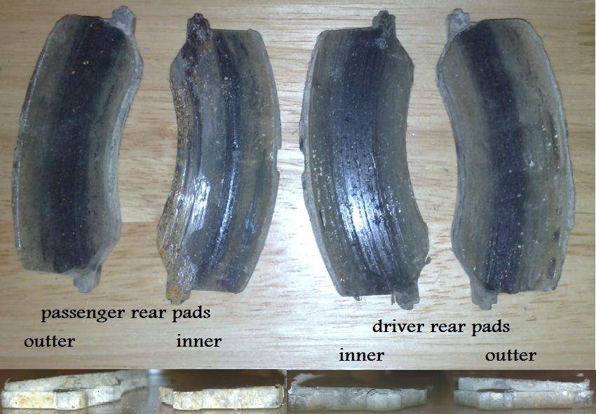

i put new pads an disks all round my sj an the rears have worn down 2 metal an the fronts look new.???
ain't it meant to be the front you use the most??????
what could cause this?

ok just checked all 4 sets there was one pad with excessive wear.
passanger rear inner pad.
did notice that all 4 rear pads where worn wonky.

blimey they are worn! how long did it take 2 get them that low? they all seem very low and if the fronts are still ok must be something holding them on. are the dics blue'd ? would be if calipers are sticking causing over heating, if not try the load compensator may be your doing most of your braking on the rears. hope this helps.

i changed them all six months ago the frunts look new an the backs are as you see them.
there is no blueing off the disk.
i think the hangers are sitting wonky an the pads are not sitting right.
wearing them unevenly fast.

defo sticking on think you need a service kit or 2

i must add i also had all 4 callipers re-bilt
Re: rear disk pads
Post by ScottieJ » Mon Oct 13, 2008 12:28 pm
how have you done your rear disk conversion, from the way the pads are worn it almost looks like the callipers are not sitting square to the disks?
